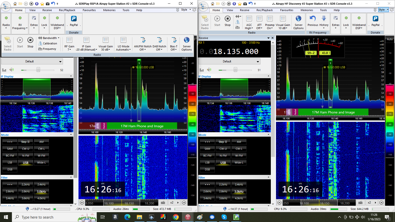

Do yourself a HUGE favor, get a real HF SDR if the HF spectrum is your primary listening choice. I use MANY Airspy HF Discovery's in my fleet of SDR servers. The SDRPlay (RSP1A specifically) is easily overwhelmed with AM broadcast signals to the point I had to install an AM BC filter on that server hosting it. Plus there are just too many variables to tweak such as RF Gain of 10 different settings, IF Gain with 16 different settings, and lastly Visual Gain with 15 different settings.
The Airspy Discovery has only two that have any noticeable effect, PreAmp ON/OFF, and Visual Gain with 15 settings. The AGC is set to high or low and never touched again, and the Attenuator is ONLY active with the AGC off.
If you connect to my Super Station #2, you can operate the Airspy Discovery and the SDRPlay RSP1A side by side and see how complicated operating the SDRPlay is versus the Discovery.
As an example, to get similar images on the two SDR's, it took MANY adjustments on the RSP1A to match the image of the Airspy. Yes, not really a scientific comparison (don't tell JDow!), but it gives you an idea how much fiddling one has to do. The SDRPlay is on the left and since there are so many radio adjustments, the radio adjustments covers over the S-meter. But after +10 minutes, I was able to get similar views of the 17m band this AM.
JMHO (Just My Humble Opinions)
