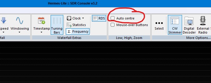

Turn this off in the "View" tab:

Thanks, Max. That didn't do anything.

If I have a certain width of display on the waterfall and I click anywhere within it the waterfall does not recentre. The tick box I pointed you to only recentres the display on changing the zoom setting. That's one of the two auto-centres I'm aware of.

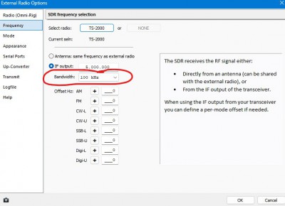

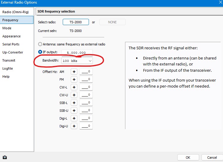

At the moment the only thing I can think of is that it's the external radio that is somehow forcing the bandwidth of the display back to 50kHz every time you move frequency. I think if you dis-enabled the External radio and used the RSP as a receiver that you would see normal behaviour.
So for starters, take a look at this setting in the External Radio options (press question mark top right of External Radio panel to bring it up). I would wager it's set to 50kHz? Try setting this to "Default" and then see what happens?

Hey Max. Changing the bandwidth only changes the received bandwidth. It does not change the what I am experiencing. It still centers the display on every mouse-click and the zoom zooms back to where it was.
