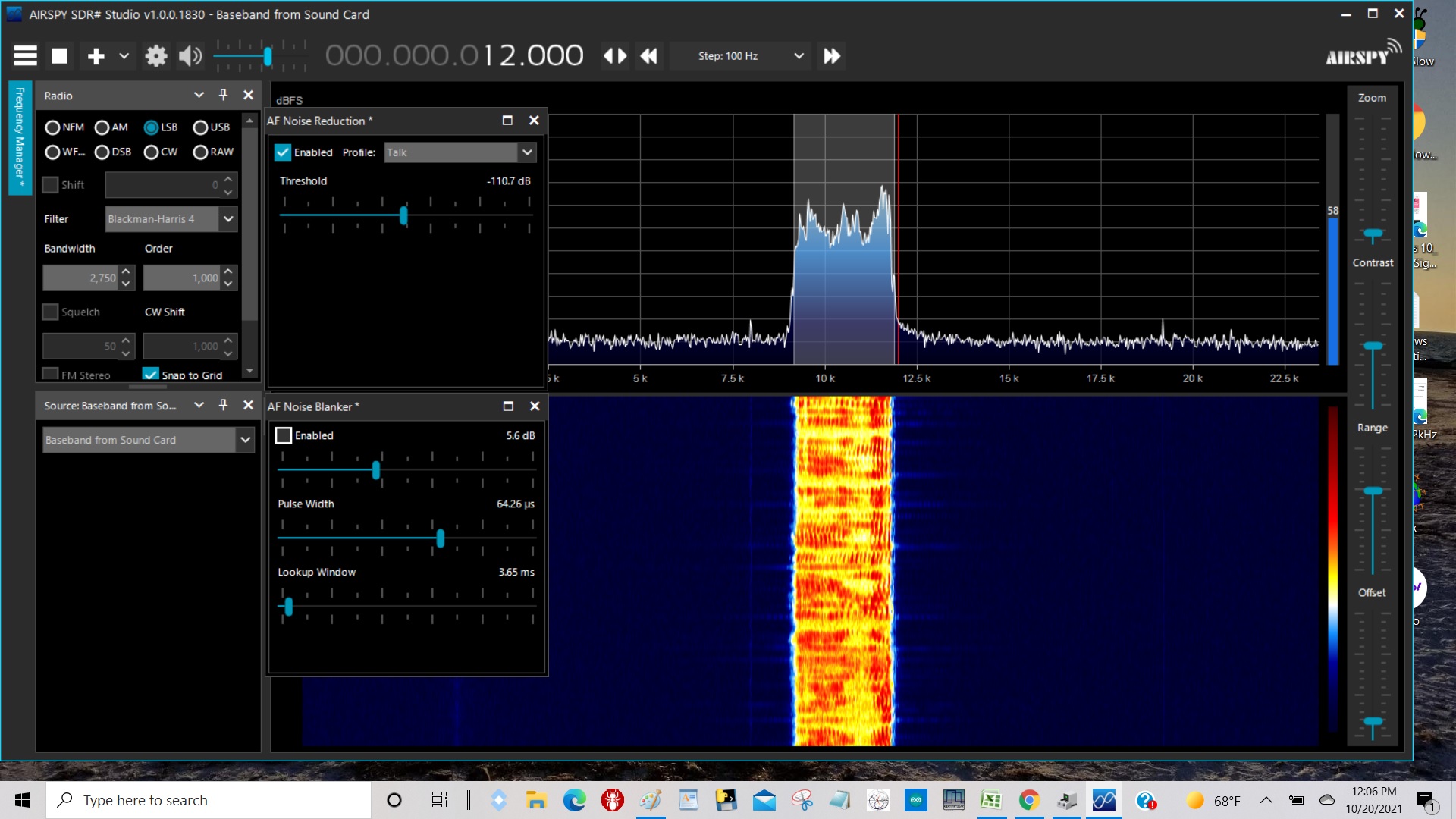

I was not satisfied with the Noise Reduction and Noise Blanking Performance of the ICOM-7300. The Noise Reduction and Noise Blanking performace of SDRSharp impressed me (thanks Joanne).
The IC-7300 has a USB IF output where the the IQ Output as available at the 12kHz IF. It is available if you set the menu for the USB output. I fed this into the SDR Sharp "Source - Baseband from Sound Card" , set the frequency to 12kHz and am very satisfied with the results.
Is this IQ baseband processing possible with SDR Console? I could not find an entry for Baseband input.
I've attached a copy of the SDRSharp screen to show my configuration.

The question is about to SDR Console. Is this baseband input feature available with SDR Console? I just used SDRSharp as an example.

I got the 12 kHz IF output of the 7300 to SDRSharp by using the baseband source. There is no equivalent setting for the 7300 on SDRC so I started this topic.
