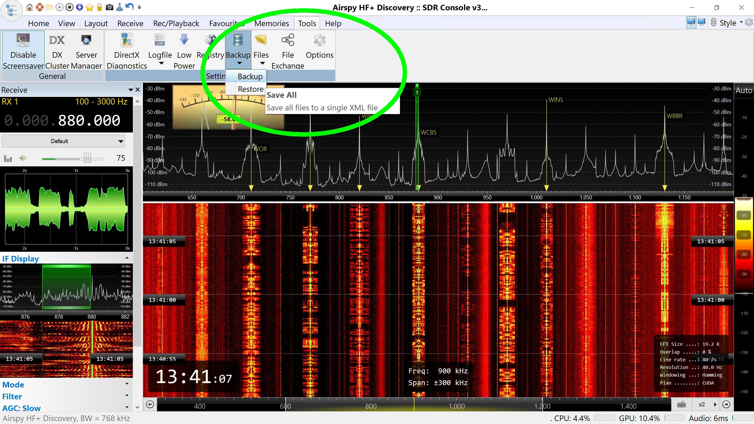

Hi Micha,
Have you tried the Backup and then Restore under the Tools menu? See attached.
Barry
WB2ZXJ
Barry
WB2ZXJ
Re: Make a 1:1 copy
Is there any reason you did not try Backup/Restore option? I think this may yield greater success. Yes, I think there are some registry values.M*I*B wrote: Sun Apr 23, 2023 3:50 pm Hello dear people,
I tried today to create a 1:1 copy from my stationary computer to my notebook in order to have exactly the same environment ready there.
I don't recall exactly how, but I know I successfully fully transferred by SDRC when I did fresh Win11 install when I rebuilt this PC about 4 months ago. I am pretty sure I just used Backup/Restore option.
(Ribbon Bar>Tools>Backup)
Also see this:
https://www.sdr-radio.com/user-settings
