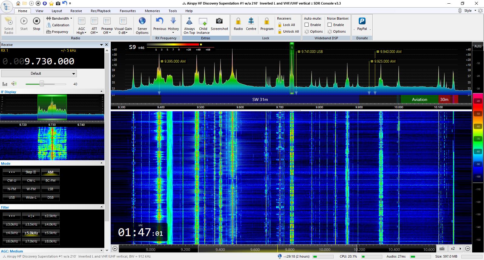

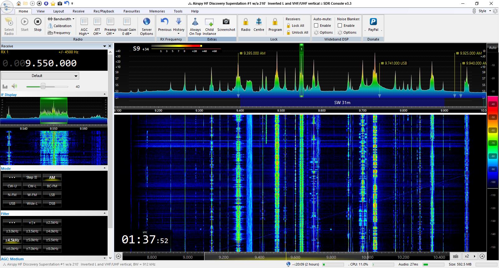

The second image you posted is of +2MHz of bandscope, if you zoom in you may find that they may be HF BC stations, see my humble 912kHz wide images attached. There are lots of them in that 31m band and 25m band! One really needs to zoom in and look for repeating QRM signals, such as every xx kHz along the spectrum. When looking at 1MHz or more of bandwidth at one time, you miss out on all the nuances hidden inbetween the -30dBm BC stations!
The activity I see in your 2nd screen shot, happens to fall right in those two bands (31 and 25m). If I were a gambling man, I would say you are hearing the HF BC stations!
EDIT!
I just realized you were speaking of the noise floor! Not the strong signals. My bad!
