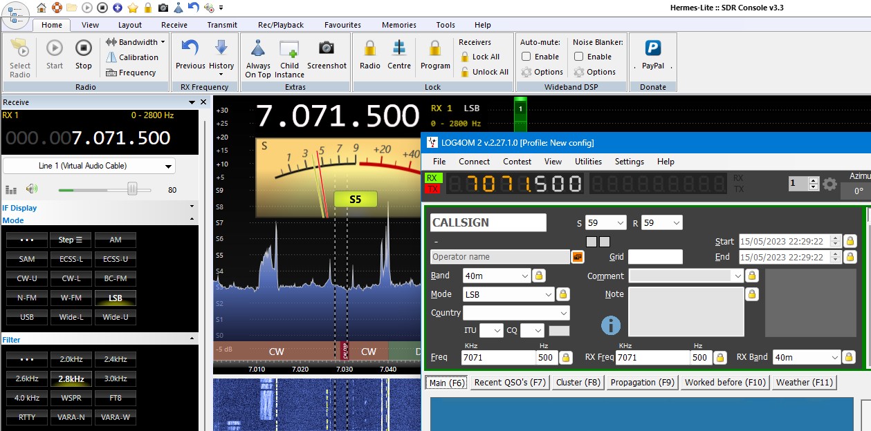

That is very odd. Using Hermes Lite 2 I get perfect frequency passing. See attached. Could it possibly be something to do with the Elad? Have you got another SDR you could try it with? An RTL-SDR dongle or similar perhaps to rule this out?

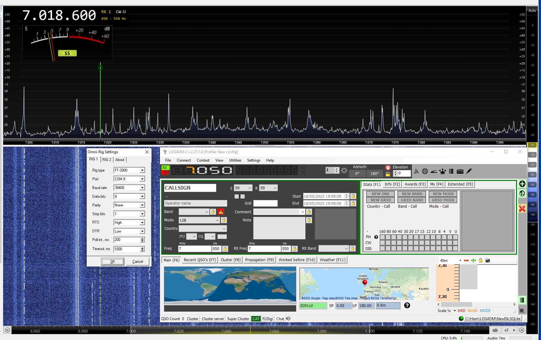

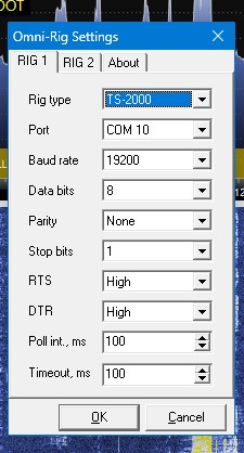

Have you got Omnirig correct version (1.2) and set to the right Com port and setup as per attached? Rig as TS-2000? For you Com port will presumably be Com8 of course? SDRC takes Com 7 (or the other way around).
Also, can you take a full screenshot of SDRC and another full screenshot of Log4OM when you have this issue and post here as attachments? Please don't crop or resize the SDRC screenshot:

A Screenshot of Log4OM and SDRC
Ports 7 & 8 were used.
The same thing with DX Commander. Dx Commander displays the full accurate frequency when running the Elad SW2 software so I'm sort of puzzled as to what is happening.
