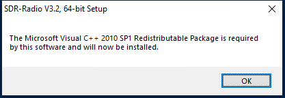

Silent installation/automated deployment of the current SDR-Radio does not seem to be possible because it looks like that its installer always displays this info message:
It happens even if the actual 64-bit vcredist package is already installed on the system.
Is there any way to fix/workaround this issue?
Thanks!

Never seen this one myself. Simon may be along soon to comment, but from past experience with other software, just having the latest redistributable is not always what's needed. May need some particular component of that exact version of the Redistributable. I'd just go ahead and install it then I think you will find it shuts up. I've never had an issue with doing that. Just let it do its thing!

Sure, when doing standard installation, it is not a problem to confirm the vcredist installation. However, when doing automatic deployments or using tools like WinGet / Chocolatey, the installer needs to respect the silent installation switches otherwise the installation cannot continue.

Sorry, silent installation cannot be guaranteed.

I just checked the installed script, a couple of Message Boxes did not have the silent installation option. Future kits should be OK.
