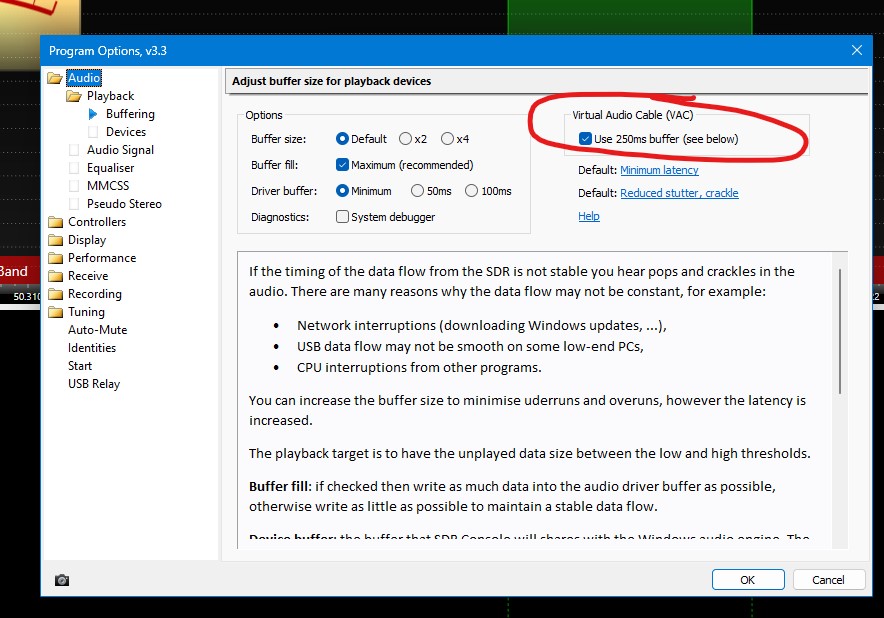

Also I can see in the past (not necessarily this exact issue, but problems with virtual cables) that Simon recommends to tick the box "Use 250ms buffer" (see attached). Is that set in your SDR Console?
