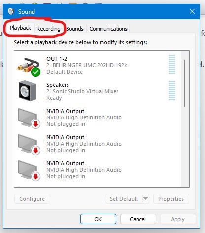

Press Start Menu (or Windows Key on the keyboard) then type "Run" (without the quotation marks). Then in the Run text box that should come up, type "mmsys.cpl" (again, no quotation marks). This should bring up the Audio Devices panel. You should see your audio devices in the list in the panel, or some at least (we hope). Firstly go to any showing and right click on it then in the dialogue box, tick "Show Disabled Devices" and also "Show Disconnected Devices". Then go through each one audio device in turn, right click on it and select "Enable". My guess from your description is that they have been set to "Disable" for some reason.

Max wrote: Wed Oct 04, 2023 9:59 pm Then go through each one audio device in turn, right click on it and select "Enable". My guess from your description is that they have been set to "Disable" for some reason.
I should have said you will need to enable all of the devices you want to use in both the Playback tab and also the Recording tab of the Audio Devices panel.
