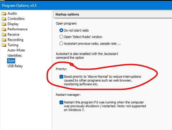

Have you got "Boost" setting enabled? (See attached)

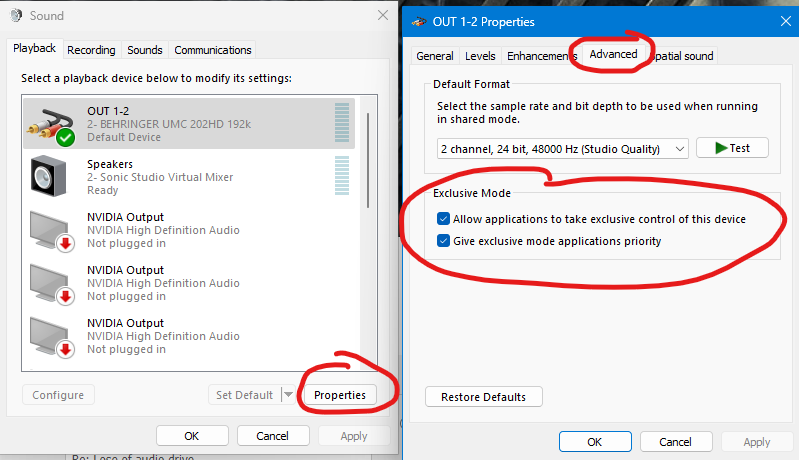

Also, press Windows key, type "Run" (without quotation marks) to bring up Run dialogue. Then in the Run box type mmsys.cpl and press enter to bring up "Audio Devices". Maybe have a play (Advanced tab" on the device that keeps getting taken away, with the tick boxes. Maybe until "exclusive priority" for the device in question? Or if it is already unticked, try ticking it. I guess it depends on which program is able to take exclusive priority! (See attached pic)

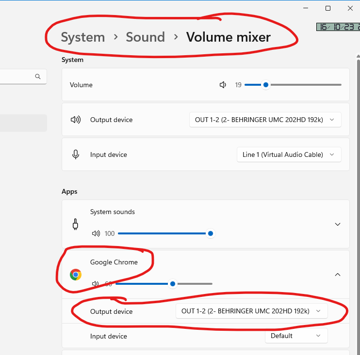

Also check what is the default output audio device for each program? Hit "Windows" key then type "volume mixer" and see settings as per the other screenshot attached.

I have been using two browsers, "Brave" and chrome. Neither one shows up in sound>mixer>apps but Brave browser does NOT take over like chrome does. Any opinions?

Re: Lose of audio drive
Play a youtube video. That is when the browsers open the audio port.
