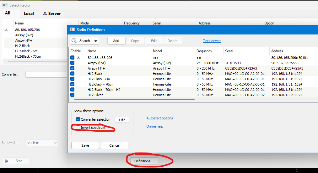

I am not 100% sure, but is it not the "Invert Spectrum" option you need to enable in the "Definitions" options when LO is high?pe2bz wrote: Mon Oct 16, 2023 10:40 am Hi,
I am wondering how SDR Console (v 3.3 ) handles the downconverter settings for by example LNB use, when the LO frequency is higher as the RX frequency.
Ben
See attached image.
- Invert.png (58.25 KiB) Viewed 6503 times

Hi Max, thanks for the replyMax wrote: Mon Oct 16, 2023 9:53 pmI am not 100% sure, but is it not the "Invert Spectrum" option you need to enable in the "Definitions" options when LO is high?pe2bz wrote: Mon Oct 16, 2023 10:40 am Hi,
Ben
See attached image.
I overlooked this setting, but the bad news is that does not appear to do what I assumed it to do. I made an excel sheet with the IF I have to tune to and have that subtracted from the local oscillator to calculate the RX frequency. Wiht both the downconverter and invert spectrum enabled I do not see the signals at the expected 19 GHz range when tuning, but they still are around the IF output frequency, but , the spectrum is inversed, as in, I have one "transponder" with moving bandwidth at the left side with the "invert spectrum" off, and that shows the moving bandwidth at the right when "invert spectrum" is on. So the IF output might indeed show the right results now for the LO being higher as the RX frequency , but the signals show not on the expected 19 GHz range.
Any other suggestions ?
Ben

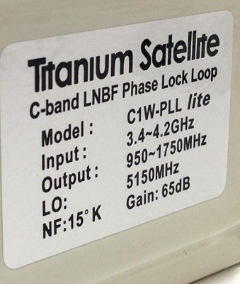

These are the specifications of a typical C-band LNB.
OL - IN = IF
5150-3400=1750
5150-4200=950
In this case spectrum is inverted.
It is a down converter
it would probably be enough to allow the negative sign in the RX OFFSET field in converter definition
Rocco
OL - IN = IF
5150-3400=1750
5150-4200=950
Rocco
- lnb_c_spec.jpg (37.52 KiB) Viewed 6426 times
