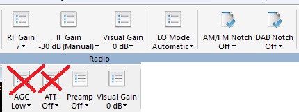

The RTL's I use for an ADSB RXR for Flight Radar24, nothing else. The RSP1A I have, I try not to use it due to easily being overloaded from AM BC stations when used on good antennas. The Airspy hass less controls to fiddle with (only preamp on/off or visual gain), no extra drivers to load, and work well, providing you don't need to look at large swaths of spectrum at the same time (912kHz max on the HF+ Discovery). The RSP1A has all these adjustments, top image. While the Airspy (lower image) has fewer adjustments, which the first two you rarely touch. The pre-amp is turned on on 20m and higher, and the visual gain maybe once and a while.
