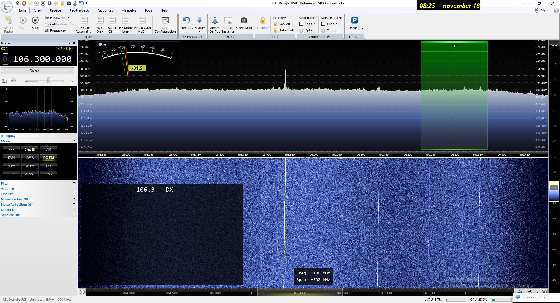

hello new here im having issues with the rtl-sdr v4 i just got home a fewdays ago all programs i try sdr#, sdr++ and sdr console shift the local fm stations for an example 106.3 is located at 56.3mhz sdr# had a shift frequency option wher i can manually put in the shift but it dont save it and sdrconsole has a 0.1-100ppm buttons is there something im missing and it kind of feels like a bug one shouldnet have to shift it that much?

Also please take a screenshot of SDRC in the "fault" condition using the SDRC built-in screenshot tool and post it here. Do NOT crop or edit the screenshot. When you take it, on the top ribbon bar make sure HOME tab is selected.
Please ATTACH it do not insert it as an image to the message. To see the attachment facility, scroll down below the message window you are typing in when replying.

- Screenshot-2023-11-18-082547.jpeg (399.98 KiB) Viewed 2996 times

If all SDR programs are bad with that dongle, then that dongle is broken. That is not unheard of. Now, exactly 50 MHz (not "milli-whatzits") off frequency on 106.3 MHz is quite unusual. Pick another FM frequency - is it off the same amount and if not how much is it off?
A picture showing settings, including the dongle settings, might reveal something. Whose V4 is it, rtlsdr.com's or NOOELEC's? They have different behaviors. Do any other dongles you may have work properly?

As Joanne says, if it's 50MHz off on all software then most likely a hardware fault.siroxone wrote: Sat Nov 18, 2023 7:29 am hey max
i bought the rtl-sdr blog v4 i bought it from rtl-sdr blog ebay store followed a link from thier site.
Nevertheless an observation from your screenshot is that you are running SDR Console 3.2. This version does not have the full support for the RTL-SDR Blog V4 dongle. You can see in the title var it is reported as "unknown". This should show this:
Update to the latest Beta 3.3 and you will see some slightly different options in the "Radio" part of the ribbon bar, principally some changes in the HF mode selection.
So firstly update to Beta from download here (currently Build 3131):
However, I don't feel this is your issue due to what you report with ALL software. I would send it back for an exchange anyway and then check again with the replacement.
