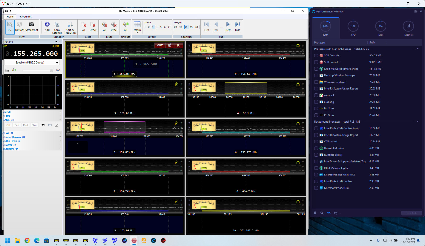

Picture? Settings are important. Show all floating windows so the configuration is known. Otherwise Simon may be left with too little information for debugging.
(Full size attachments, of course.)

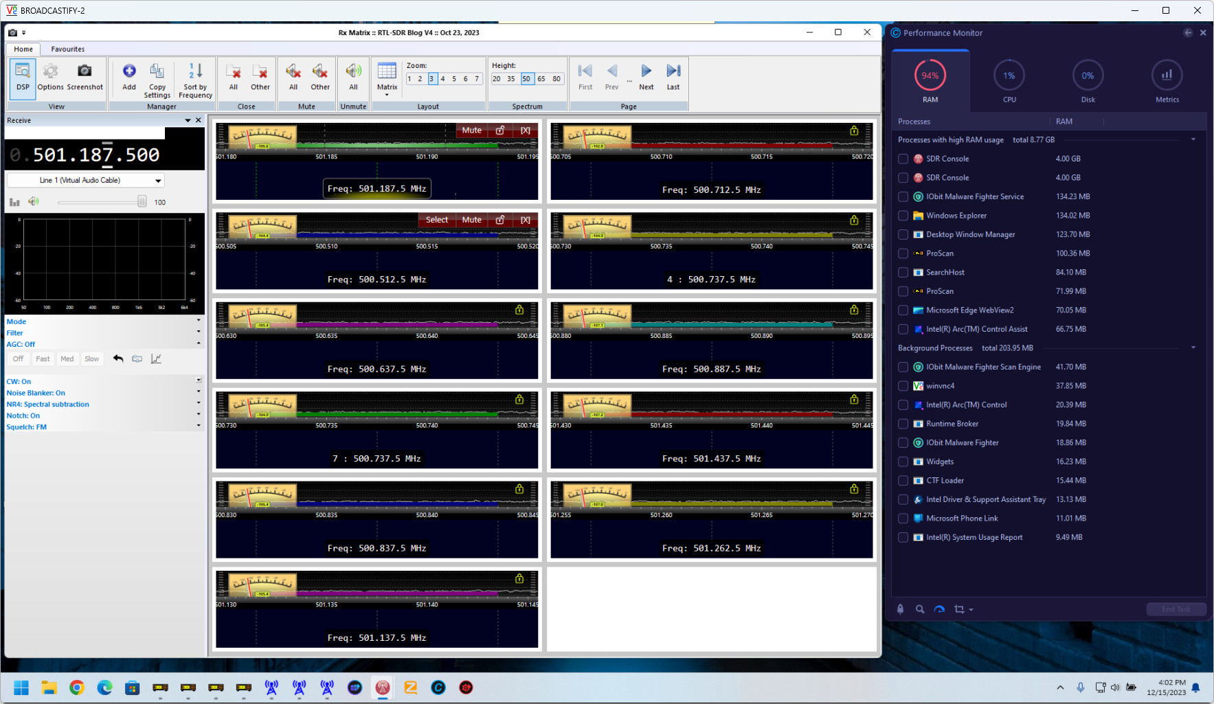

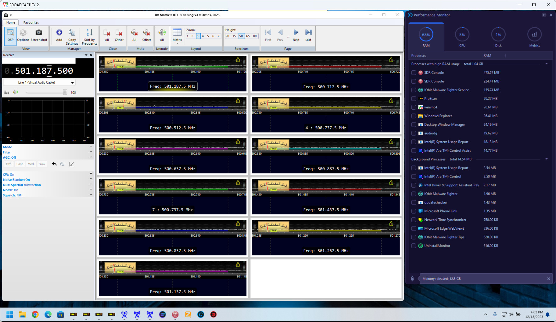

Sorry for the delay, here are some screenshots.

Regarding crashing, I'm am pretty sure I read something similar a short time ago related to window positioning, particularly I think maybe it was the RX DSP that was detached in that particular case (I might be remembering this incorrectly). Maybe experiment with some different window layouts to see if same occurs and if so try and pin down to which layouts cause the issue and which don't. TBH it's the first time I even realised that RX DSP could be enabled in the RX Matrix window. Also looks from one of the shots that you may be running two instances of SDRC simultaneously? If that is so, what about running just one instance. Same issue?
As Joanne has asked, do you have any other panels floating and not docked that we can't see in the screenshots? Or do you just have two windows open, the main SDRC window and the RX Matrix window?

OK, I see a note at the top of the resource monitor that says high ram tasks are consuming (only) 8.77G of ram. Are you sure you really have 64G of ram? Is the onboard graphics of the CPU chip turned off? If not how much ram is allocated to video? SDRConsole surely is not using all that ram. Only two instances are shown with each using 4G. My working hypothesis is that the onboard graphics are enabled and told to use (more than) 50 G of ram - or some of your ram is kaput. That can be checked with "TaskManager" using its performance tab and the "Memory" selection on the left.
