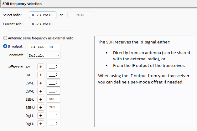

I'm running a pretty straightforward setup. It's normal, as I understand, for IF offsets to be different by mode -- thus why most SDR suites have settings. I am running an Icom 756 Pro III with 64.445 MHz IF output. SDRC changes the center frequency of the SDR whenever the mode is switched, to adjust for these offsets -- see previous comments with details from the log file.

Re: External radio IF offset not updated / applied when changing modes
Some of this is train of thought typing. Please bear with me and slog through to the end. ICOM may do something funkity. I wish my Pro II was still functional so I could try to take some measurements. I never used it that way. I'd have used a tap off the antenna feed or a separate antenna.
SDRC moves filters. It does not move the center frequency. It has what I consider a defect in that the Receiver windows report their center frequency rather than the possibly phantom carrier frequency as is convention. You might be seeing that and misinterpreting it, in which case you may not be operating where you think you are.
I see from the picture that you have set some utterly preposterous offsets. All receivers I am aware of that use up conversion for the first IF have no offsets. The reason for this is obvious once you consider what the offset might be used for, USB sideband filters. Tune high for LSB and tune low for USB. (That presumes low side up conversion, reverse for high side mixing.) A typical IF is near 70 MHz. Temperature drift for quartz in filters is not unusually 25 ppm or more. That would mean about 1,750 Hz drift, totally compromising the SSB filtering capability. So they handle that selection in the second IF at more reasonable frequencies for filters. SDRC does not fiddle itself around to change where the tuned frequency lives. Thus you should have zeros where you have the outlandish 4000 Hz and 7020 Hz values. I have no idea what drove you to those settings other than a misinterpretation of how an SDR works.
An SDR can setup filters with very good characteristics with center frequency offsets that can exceed the filter width either way. This is like having nearly infinite crystal filters with various bandwidths and offsets. The Pro III is not that different from the Pro II I had. It's IF is digital and somewhat rude and crude about it. I suspect it might design all its filters to have the same center frequency and offset the tuning to perform sideband selection. Since the VFO is effectively the first conversion oscillator that would shift things around at the 64.455 MHz IF. (64.455 or 64.445? Whatever) So you would need to use offsets. In that case the offset should be near or a little more than half the width of the selected Pro III IF filter. That cannot be saved because it is not known by SDRC. It could be. But, I'd not have designed that in. It appears Simon did not, either. (2.7 kHz filter would have an offset of 300 Hz plus 1350 Hz, for example.)
If your rtl dongle is old it is likely to drift a lot. I seen one old one drift several kHz as it warms up. Newer ones should not have that problem. I wonder if you are seeing some spectrum inversion effects from the rtlsdr's high side mixing. (I have 6 or so of them, some old some new, and have grown to seriously hate the little buggers for their performance issues.)
Try inverting the spectrum and see if that brings some sense to the offset values you must set in. That is the only thing I can argue myself into as the source for some of your problem. Oh, check WWV in DSB mode for its center frequency. The 64.455 kHz IF setting may need some tweaking. The SSB offsets should be the same for the same filter width selection.

Thanks for the detailed response. I should add that I have the spectrum inverted and with the current settings it is performing 100% as expected.
The "utterly preposterous offsets" were adjusted solely to make it behave correctly. As I'm writing this, I'm realizing I do have a typo in the first IF -- it should be 64.455 MHz not 64.445 MHz. With the incorrect value 64.445 MHz, the offsets are +4000 SSB-L and +7020 SSB-U. I've changed it to the correct 64.455 MHz and changed the offsets to -6000 SSB-L and -2980 SSB-U. The result is the same...behaving correctly in both modes.
I don't understand the details of the SDR frequencies as much as you do, maybe I am mis-using the term "center frequency" but as I've posted previously the logfile shows SDRC setting the RTL-SDR frequency each time I change modes from LSB->USB and vice versa.
Setting mode to USB (IF frequency + USB offset)
Setting mode to LSB (IF frequency + LSB offset)
I do notice the temperature drift, although it's not a big issue for me, especially since I am mainly using the SDR for the waterfall display, not actually to receive audio. If it's 50Hz off, when I click it tunes to the nearest 500Hz therefore close enough for tuning -- even if not close enough for receive audio.
I suspect the filters in the 756pro3 are applied after the first IF. When I change from 3.0k to 2.4k to 1.8k on the rig, there is no change in the SDR output/receive.
I guess you're suggesting the USB/LSB offsets should be symmetrical? Ultimately what I need is 64.449.000 for LSB and 64.452.020 for USB. Rather than my current IF and different offsets, would it make you feel better if I used the following...
IF = 64.450.510
LSB = -1510
USB = +1510
IF = 64.450.510
LSB = -1510
USB = +1510
I suspect I want to dig around what the Pro series uses as the digital IF. I suspect they fudge things a little. You might see some more expected numbers and settings results if you use the real IF you found.
If that front end is an old rtlsdr such as an E400 tuner or one of the early R820T units from the commercial digital receiver market then you could have a crystal that far off. A ham repeater output may be stable and accurate enough to tell you something useful about the dongle's calibration comparing what you read and it's nominal frequency. Of course, it does not have to be an old one. The VCXO in one of my rtlsdr.com dongles has gone WAY off frequency.
And with numbers made to look sane I wonder if I can get Simon to comment on the offset not being applied when you startup. That seems to be what you have as a problem. Does that sound right to you?
Oh, and I do believe the Pro series all used the first oscillator as the sole tunable oscillator so any offset it uses would have to be done in that oscillator. That's not the way I'd do it. But their digital IF is so low that it may be constrained that way.
