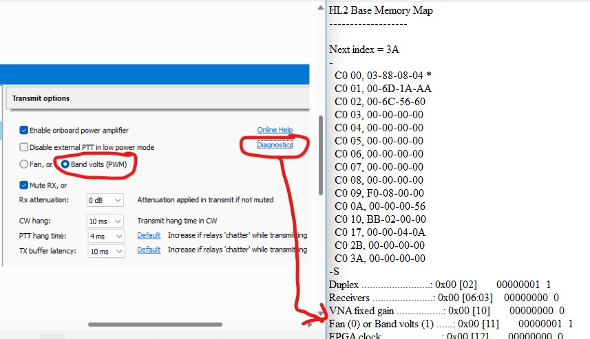

I just checked diagnostics and the address (0x00 [11]) does seem to be set correctly. See attached pictures.

Heiko, it looks like Reid on the HL2 Group has solved the mystery.
You must activate TX DSP panel on SDRC in order for the band volts to work. Seems that only when TX frequency set is sent to HL2 that the band volts change.
Sorry, I had assumed in original post that you had TX DSP activated. This is why always useful to post a screenshot with initial question. Must be attached not inserted into text as an image. Also should be full uncropped screenshot:
