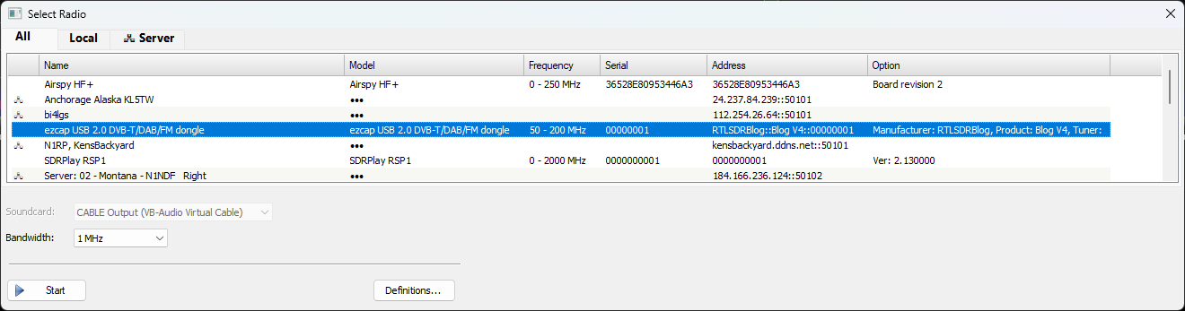

I too have installed RTL-SDR V4 and Console looks like its operating but nothing heard, as if the RF gain is zero. I have gotten it to work in SDR#. In Console the dongle is identified as "RTL Dongle USB - Unknown"
Does anyone have a solution?

I'm talking about local mode. Possibly the attached image will help.
