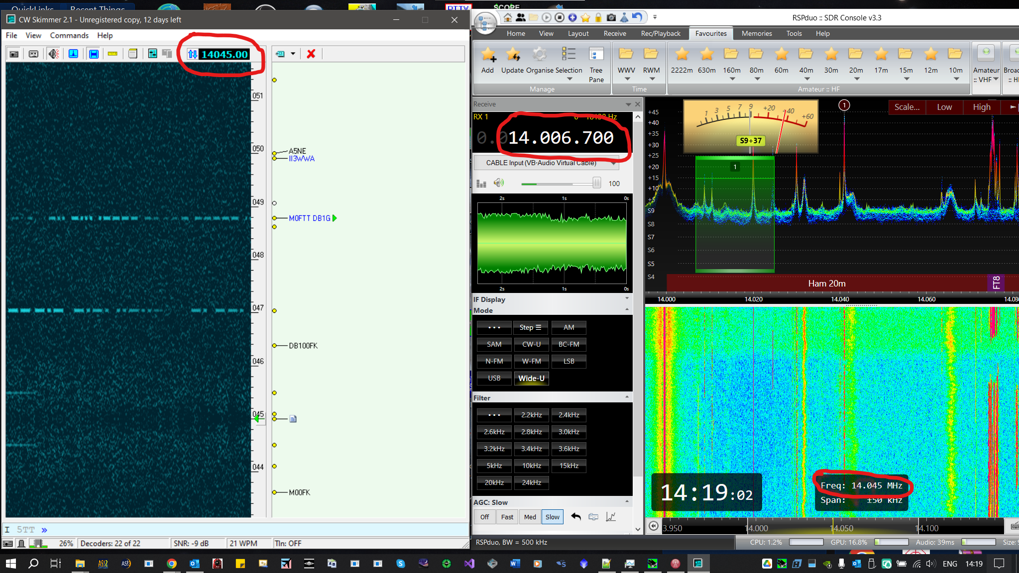

So I did some debugging, and to make it easy reproduceable I did not use any of these programs (Bandmaster or CW-skimmer) but just using the Omnirig client program that is standard installed if you install omnirig from dxatlas (ver 1.2)
I recorded this om my PC using OBS studio, so hopefully this helps.
What you see is the following :
When just started the frequency of the omnirig is in sync with SDR-console, when you make changes of the frequency in the receiver box of say 1000 kkz the freq is changing also in omnirig as the center frequency of the VCO also changes. However if you make changes of say 100 khz than omnirig does not track that change at all. When yo change the center frequency at the bottom of the waterfall, omnirig is always tracking that.
It looks that SDR-Console is sending the center frequency to omnirig and not the actual frequency used by the receiver.
Also what is even more important to be fixed is that when I set the requested frequency in omnirig client and I press the set button, SDR-Console does change to that frequency, however omnirig then declares the TS-2000 rig as being "off-line". The only way to fix this is just open the dialog box
and as soon as you click on OK, everything is in sync again.
Maybe you can now repeat these steps by looking at the attached video and fix this.

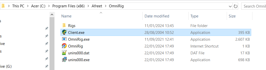

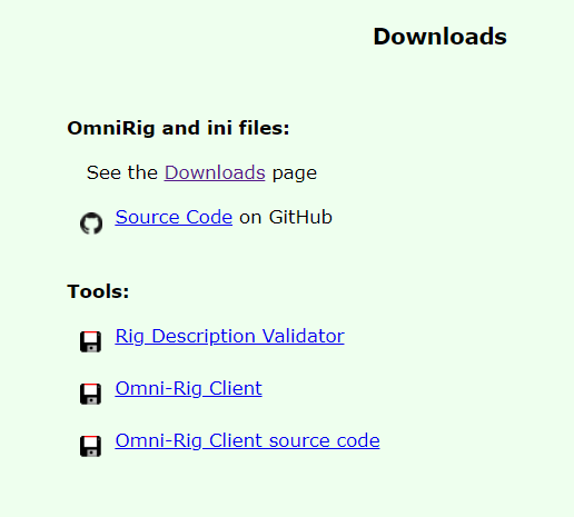

The program that I used to test the Omni-Rig interface is called client.exe
and you can download it from https://www.dxatlas.com/omnirig/ it is listed under Tools

What I notice is that SDR-Console reports back the center frequency of the VCO and not the actual frequency.
So when you start SDR-Console and say Bandmaster (or CW-Skimmer) all is OK as they sync up initially.
When you than for instance change to another band 40m -> 80m all is OK as SDR-Console also will change the
center frequency of the SDR-Play duo RX.
However if you click on a station to tune to it, the RX freq changes (because of te offset added) but the center frequency stays the same and hence you get the time out.

RudyOtten wrote: Mon Jan 29, 2024 9:46 am Good day Max,

I did read the instructions and yes its clear that the intention is that CWS is driving SDRC and not the other way around.

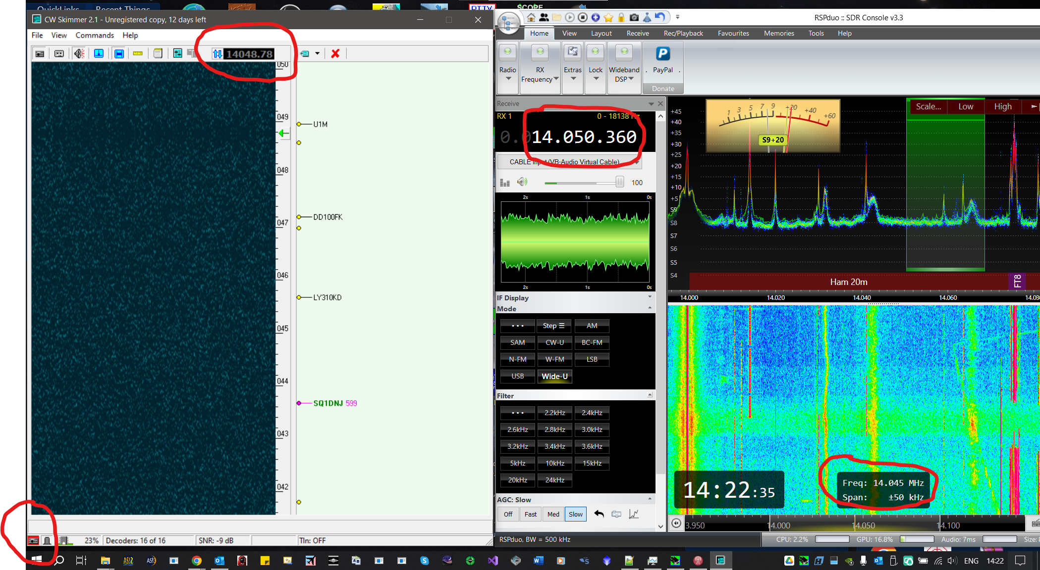

But as mentioned before, it looks that it has nothing to do with CWS or Bandmaster, what in my opinion is causing the issue is that
when you adjust the frequency via Omni-Rig and the change is big enough so that the center freq of the VCO is changed then all is OK, but with a small change
the offset into the I/Q signal is changing and that is not reflected back to Omni-Rig.
See the 2 screenshots I attached.
As you can see in the file called CWS-After-Tuning.png in CWS the RIG is flagged off-line after you make a small change in freq.

RudyOtten wrote: Mon Jan 29, 2024 6:13 pm

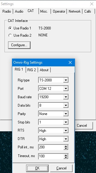

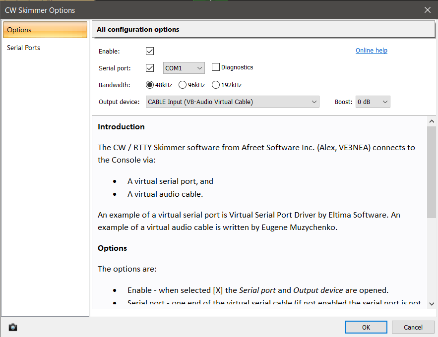

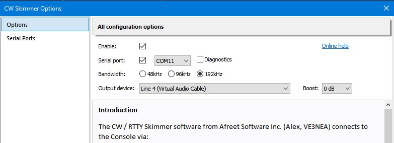

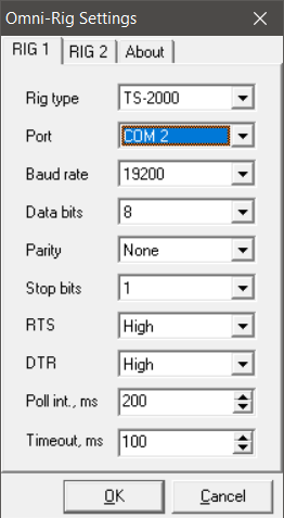

I can only say that I know for sure that when configured correctly SDRC plays perfectly with CWS. I am thinking there must be an issue somewhere in the CAT setup?
Can you please send two more screengrabs. One of Omnirig setup screen and one of the CWS settings from SDRC. Or just look at mine for reference (attached). Of course the VAC that you allocate in SDRC for CW Skimmer must be unique only to Skimmer in the SDRC CW Skimmer setup panel. Must not also have audio output on SDRC set to the same VAC.
Note the VSP should be set as pair. As you can see mine are COM11/COM12.

My setup is almost the same as you have, I only use Com1 and Com2.
I can tell you that it has nothing to do with CWS or Bandmaster or the Omni-Rig setup.

OK Rudy I think I have found the root of this issue. Sorry, it's taken me a little time to fully "get it" as I didn't have the time to sit down and look at it but now I have. I have had time to try the Omnirig test program and now I can see what is going on. TO be clear this is nothing at all to do with the RSP SDR.
What you see when you say the frequency does not change unless it's a large change in freq......
What you are actually seeing is the centre of the SDRC "span" being sent to CWS from SDRC. This exactly as expected as it communicates to CWS the centre frequency of the band of IQ signals being sent to skimmer. Basically it sets the centre of the tuning range for CWS (which matches the LO on SDR). To prove it's not rig dependent I ran my test setup with no SDR started and saw exactly the same results as you on the test program. This is normal and expected for the comms TO CW Skimmer. What this shows is that part of the setup is working correctly.
Your problem is that when you sent Freq.A back to SDRC it reports the rig is offline. I do not see this in my setup. I can send Freq A back to SDRC from the test program and it sets the exact freq on SDRC perfectly, with or without the SDR started. Unlike your setup the rig (SDRC) is not reported offline.

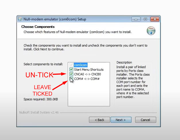

If you still see the same issue I suggest you get a copy of COM0COM and try that. That too has been used very successfully with SDRC. Indeed I've tested it myself and it works fine. I just prefer VSP Manager but seems you can't get a copy of that.
When you setup the ports in COM0COM it's important to set it up with these boxes set as shown (sorry, not as shown but as indicated by the arrows):
I am pretty sure this will fix your issue. There is no issue using SDRC with CW Skimmer. Quite a few other people on here use it. I very sure it's purely down to getting the COM ports sorted on your setup.
