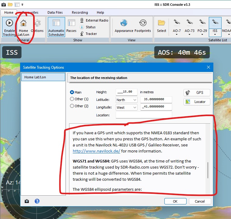

Once you have enabled the Satellite screen (from, the View tab in SDRC) in the Sat screen, press "Home" button at top left (see attached picture). Then scroll down the info box until you get to info about how to set up GPS input.
