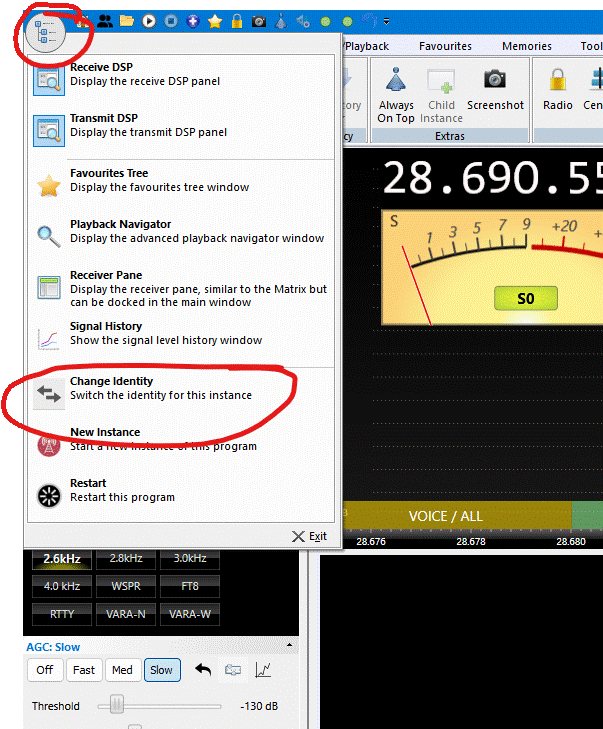

Forgot to say, to get to Identities panel in the first place:

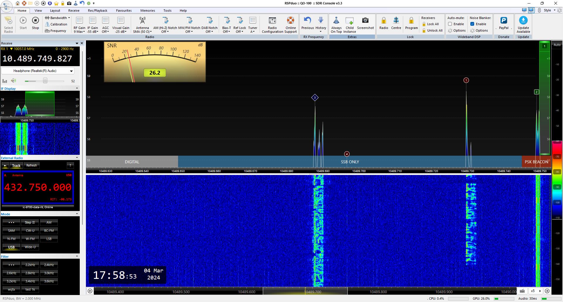

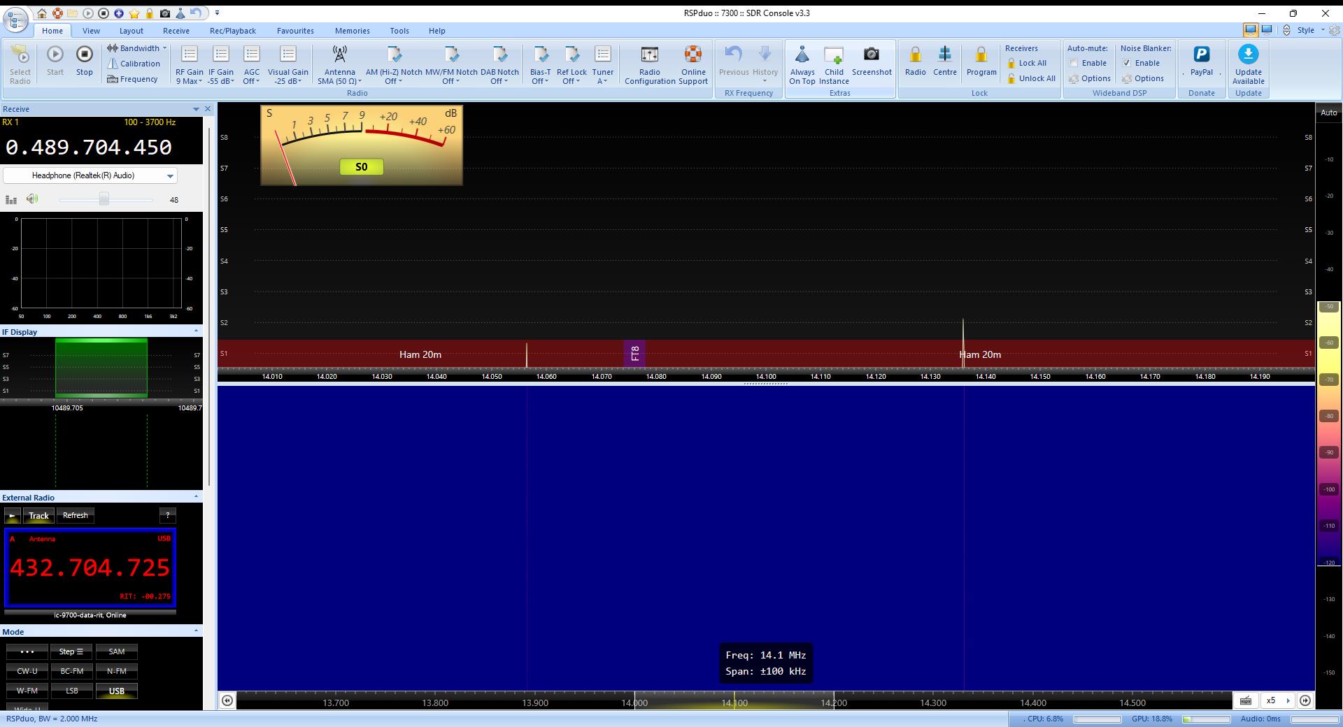

Ah yes Brent, I can see what you mean. Can you please post a screenshot for each identity (use the screenshot tool built in to SDRC and do not crop the shot) and make an exact list of which settings do not save for each identity. Is the hardware(SDR) different for each identity or the same? My guess is it's the same SDR you use in each case?
It looks to me like the Radio panel settings (the ones specific to the hardware) are not saving per identity. I think maybe this came up before and I raised it with Simon. In my case, I have Hermes Lite SDR and I want to use it both "straight" for HF and also as a transverter driver, with different TX settings, like the PA gain for example, and whether the PA is enabled etc, and I can see in that particular panel the settings are not being saved per identity.

equipment is sdr play duo ic 9700 and ic 7300
these settings all stay the same no matter which identity I chose.
1 Radio selection omnirig
2 offset frequency
3 rf gain
4 if gain
6 agc
7 visual gain
8 tuner a/b
maybe more but these are the ones I notice at the moment Max.
Regards Brent
