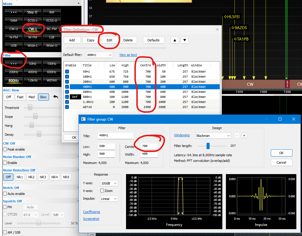

Just to point out, you can "tune" all of your CW filters by editing them to your preferred audio frequency by making that the centre frequency of the filter. In my case all of my CW mode filters are set with 700 Hz centre frequency. It's then extremely easy (especially using keyboard cursor keys for frequency adjustment with spectrum zoomed in a little) to exactly centre the signal in the filter (using the centre cursor line) and the tone will always be the same. Goes without saying that in transceive mode, you will then also be correctly netted onto exactly the TX frequency of the station you are receiving.SFortin wrote: Thu Mar 07, 2024 1:05 pm When CW mode active, a means to park the peak of the CW signal in the middle of the filter window, like many HF transceiver's can do. I think it's essentially a search for peak signal strength +/- from the current VFO.

With filters set up as above, when you click on a station callsign in the Skimmer, this centres it bang on on the middle of the filter so your preferred receive tone is automatic and of course you are exactly netted onto the other station's carrier.

Anyway, let me see if I can figure out how to put the center of my filter at 800Hz, which is my preferred sidetone. I'm using a RSPdx to process the signal being sent from my transceiver.

Samuel, see the attached picture for how to set centre frequency of CW filters to your preferred tone frequency. As you can see mine is 700Hz.SFortin wrote: Fri Mar 08, 2024 5:36 pm Anyway, let me see if I can figure out how to put the center of my filter at 800Hz, which is my preferred sidetone. I'm using a RSPdx to process the signal being sent from my transceiver.
