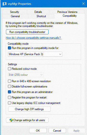

When using VSP Manager to set up the virtual com ports, go to Properties of the VSP Manager .exe file and set "compatibility mode" and also "Run as Administrator" (see picture):
