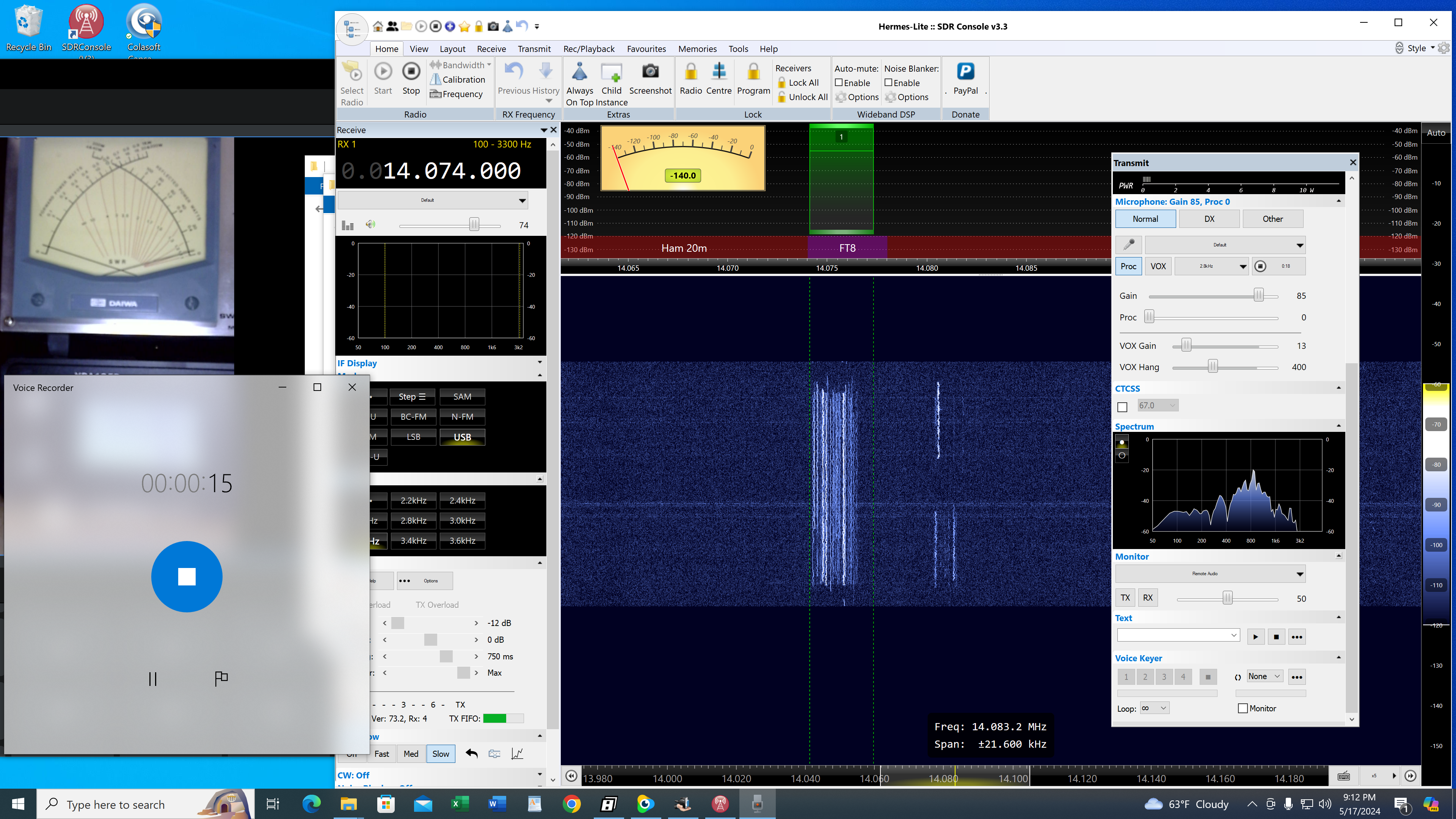

I have attached a screenshot of Console.

The first thing I notice is you have PROC enabled on the audio input (although I see it is set to Proc level 0). This should be off for any data modes. Personally I set up the "Normal" input position for mic inputs with Proc enabled and the "Other" input for data modes using VAC.
The other main issue to check for if you get unpredictable audio in SDRC is to make sure that the sampling rate for ALL devices in the chain is set to 48kHz. The default in a lot of Windows devices is 44.1 and this often causes issues with SDRC as it uses the rate of the audio on the input to clock the chain.
I also note you have Default set as input, so check 100% that the default device is the correct one in Audio Devices. Personally I never use Default as I like to see a very clear indication from the name of the source that it is using the right source and so prefer to set it manually. Sometimes Windows Default sources get changed in the background and you are then not sending what you think. You say you recorded the audio, but it's just possible without knowing for sure, that you recorded two different chains without realising? Not saying you did, just saying it's possible. Windows audio system is not the most ergonomically great!
