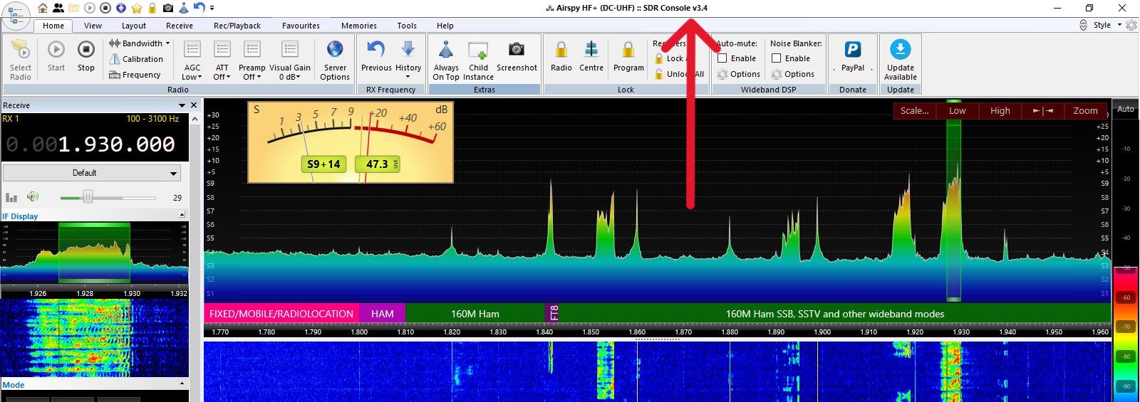

Why go through all the trouble when SDRC tells you on the screen what version you are currently running?
It's centered just above the ribbon bar, see attachment.

I know the version number, WINGET doesn't. When executing a command, such as, winget upgrade --all (similar to sudo apt update && sudo apt upgrade in Linux), it excludes SDR Console (V3) because it can't find the current version.
WINGET is a simple way to keep the majority of Windows apps updated.
