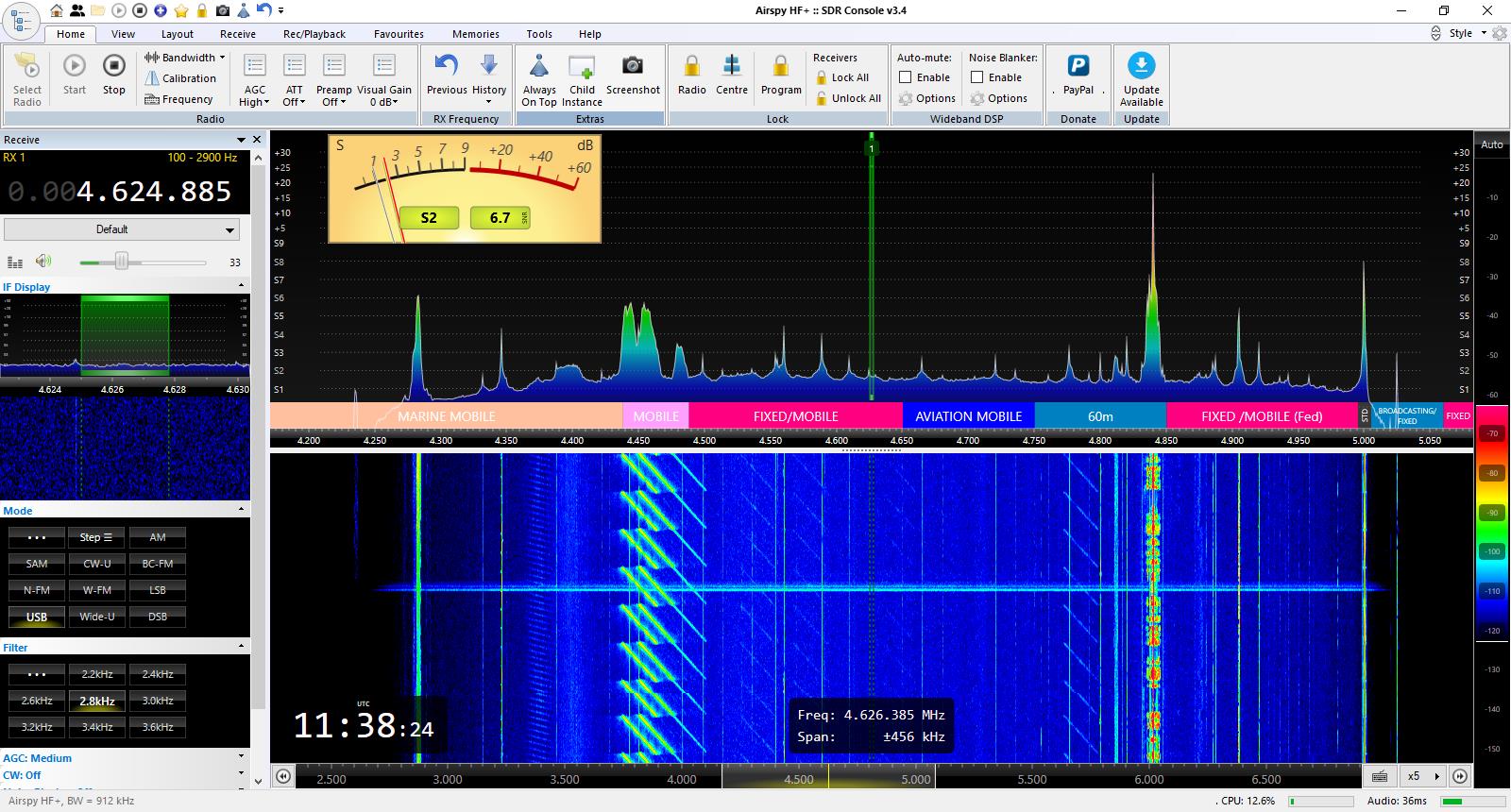

Here's a shot of the same frequency as heard/seen in NH this AM via one of my Airspy HF+ Discovery's, set for max bandwidth of 912kHz.
