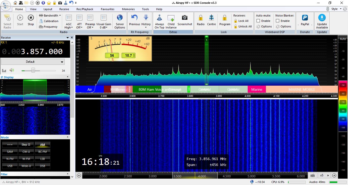

How about a screen shot showing the spectrum at max bandwidth (912kHz) so we can see what the noise is. I.e. is it repetitious appearing every 17-25 kHz in the 75m band or thin streaks on every 10kHz from 160m through 80M. The former would be switching power supply noise, the latter would be AM BC harmonics.
I always attempt to solve the source of QRM, vs attempting to reduce or mask it using software.
As for me, I rarely use any NR on any rig (SDR or big box) due to the audio quality afterwards. HF SSB is not AM BC quality, but you will see/hear folks running 4 to 5 kHz wide on the bands. To those who are listening with standard 2.9kHz RX filter, it still sounds like SSB.
Attached is what a typical switch power supply looks like with it's repeating spikes throughout the band.
- Mysterious Switching Power Supply
- Screenshot-2025-01-19-111821.jpeg (182.98 KiB) Viewed 10063 times
