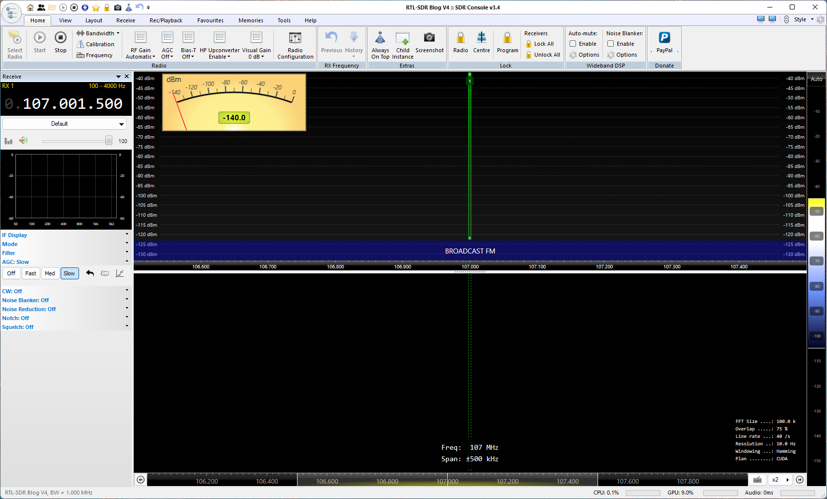

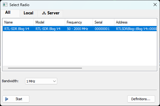

While my RTL-SDR v4 is working in SDRSharp, SDR++ and SDRAngel, it fails to work in SDR Console. It simply does not show anything and when I hit stop, the proces locks up. Tried v3.3 and v3.4 Beta. What did I do wrong?

Setup
setup
setup
Screenshot 2025-01-30 214909.png (12 KiB) Viewed 26406 times
Shows nothing
Screenshot 2025-01-30 215004.png (170.3 KiB) Viewed 26406 times
Hit stop locks the process up
Screenshot 2025-01-30 215233.png (157.15 KiB) Viewed 26406 times

Having said that, SDRC V3.4 I believe has the drivers to operate it. Have you deleted the definition and made a new one once running SDRC v3.4 beta?

Thank you for your suggestion. I've did as you suggested and removed the definition and used Search to find a new one. Same results unfortionally.
