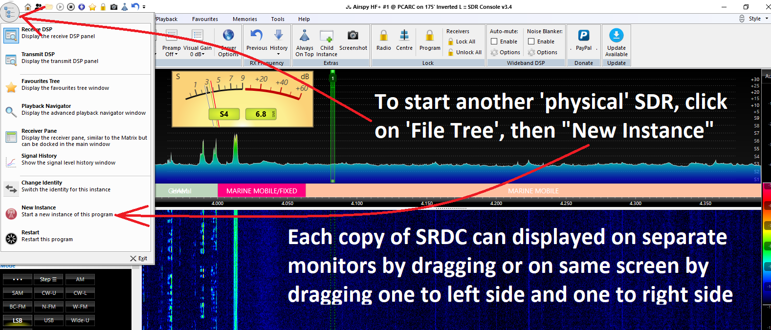

Paul, you added virtual RXR's to the current physical SDR that you are connected to. You need to start a new 'Instance' of SDRC to operate more than one physical SDR at a time.
First you must turn off all but the one RXR, then open another instance of SDRC.
See images!

Per the OP, he/she stated that they wanted start another SDR. I took that to mean there’s more than one SDR available. Also the OP stated there were different colored columns on the screen. So I took that to mean there’s more than one RXR opened on the single SDR. In my first image, you can see the four RXRs I just happened to place somewhat orderly in the 4MHz band, with notations as to how to remove them.
Without a screen shot, we’re just shooting in the dark as to what the OP really sees on the screen.
