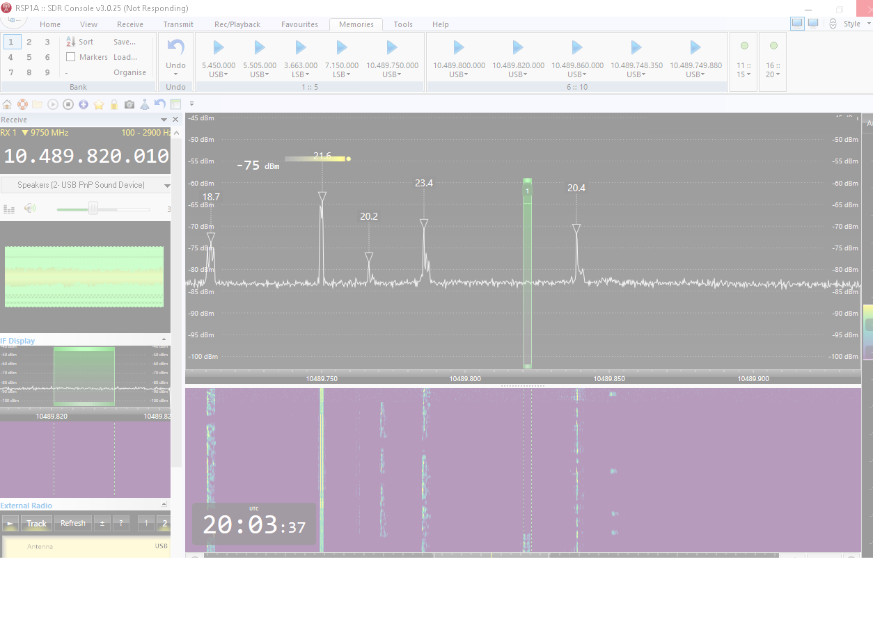

Waterfall stops but received audio continues. Task manager reports "not responding" and memory usage increases steadily. Eventually screen greys out. See screen shot.
David M0TGC
Re: 3.0.25 Random Crashes
Then it's not USB related, it's a graphics problem.

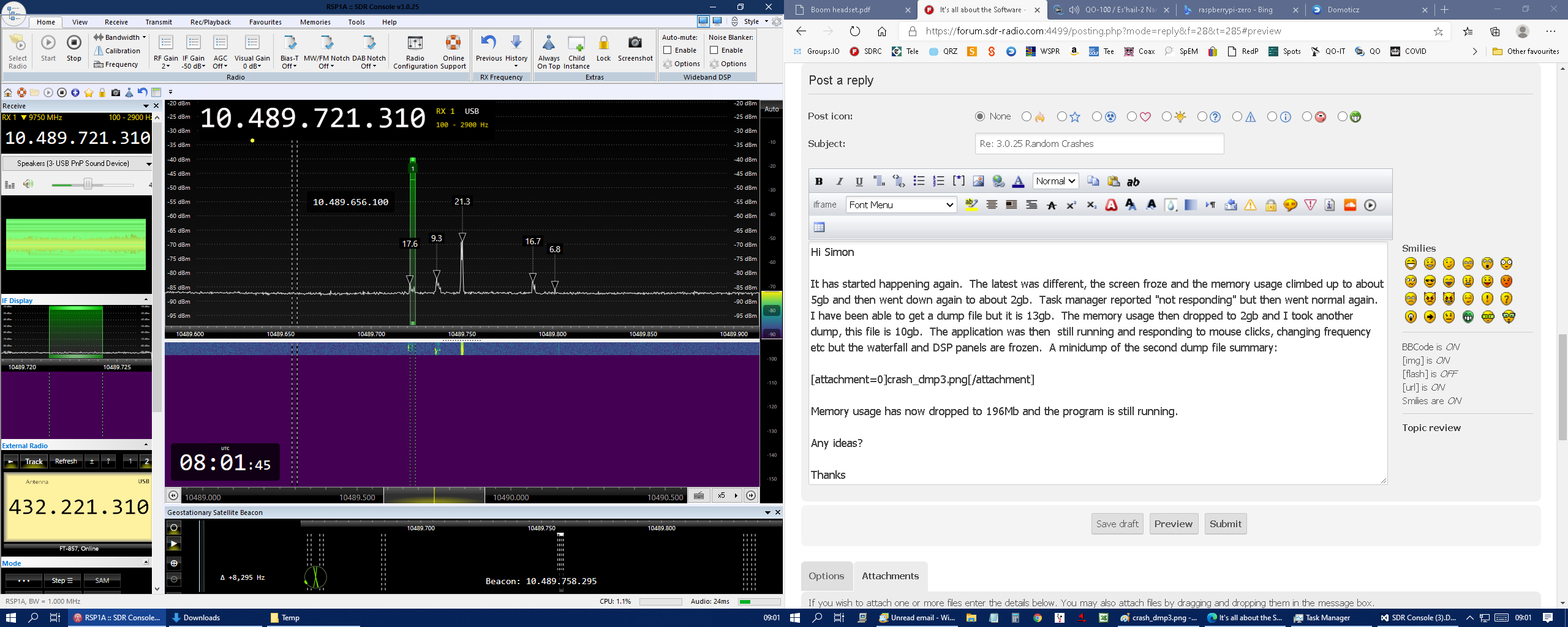

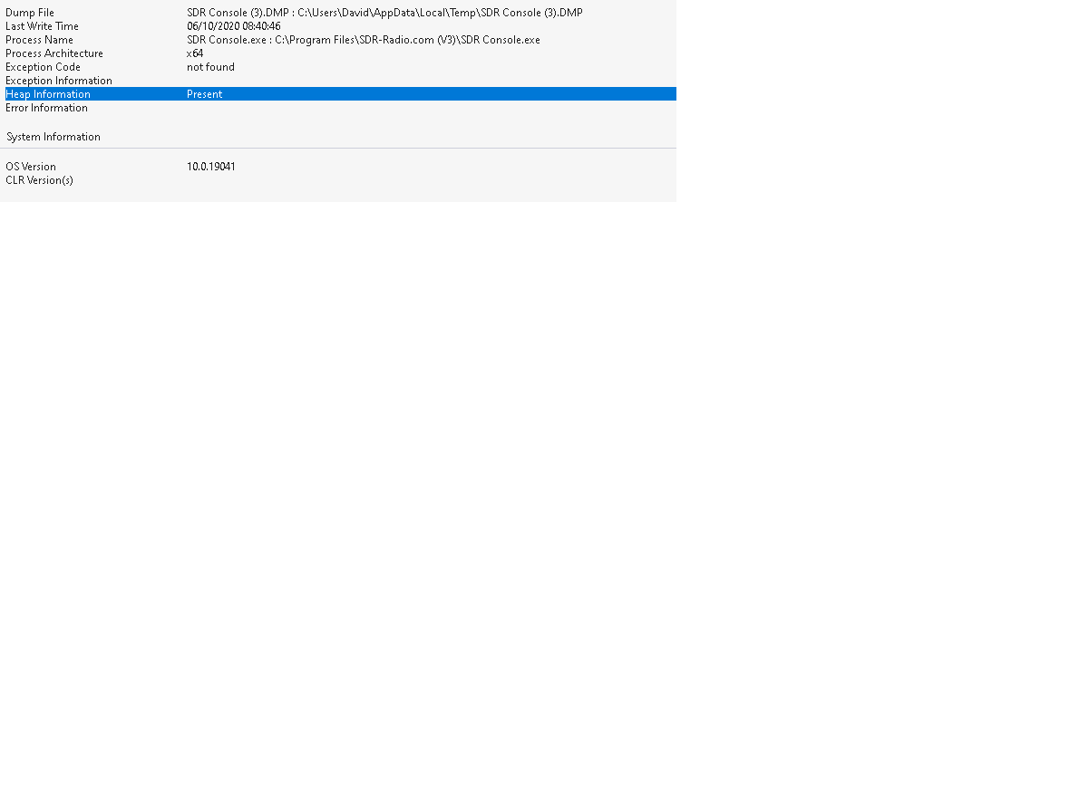

It has started happening again. The latest was different, the screen froze and the memory usage climbed up to about 5gb and then went down again to about 2gb. Task manager reported "not responding" but then went normal again. I have been able to get a dump file but it is 13gb. The memory usage then dropped to 2gb and I took another dump, this file is 10gb. The application was then still running and responding to mouse clicks, changing frequency etc but the waterfall and DSP panels are frozen. A minidump of the second dump file summary:
Memory usage has now dropped to 196Mb and the program is still running.
Any ideas?
