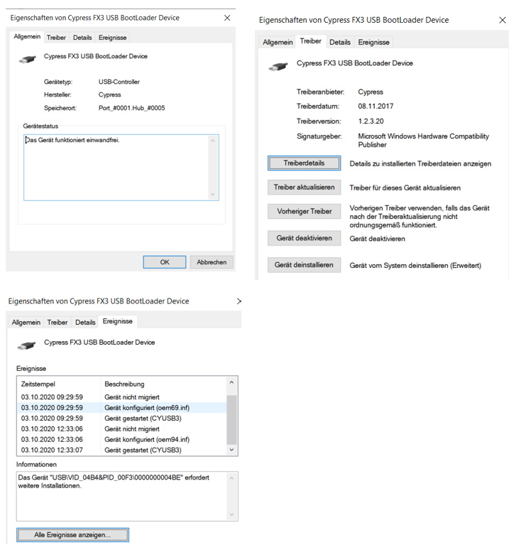

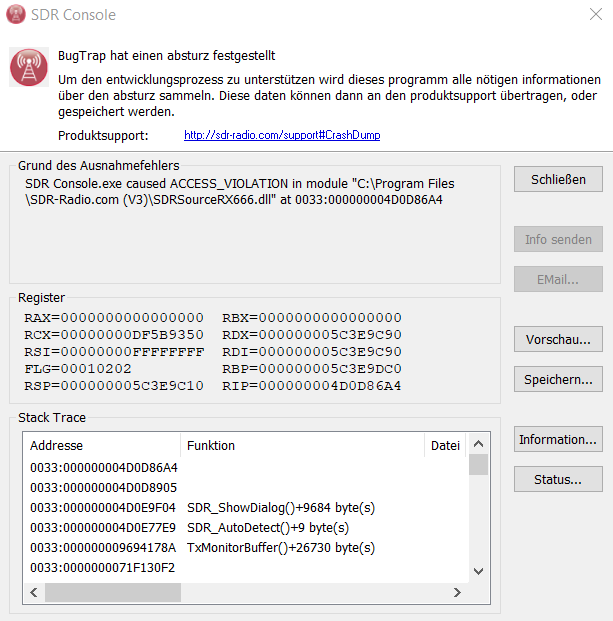

I got my RX888 yesterday. Today I tried to use it in SDRC V3.0.25. The software works fine with my RSPdx. For the RX777 I replaced the driver Cypress FX3 Version 1.2.3.20 in the device manager of my W10 to the one I found on this page. When I try to add the FX888 to the list of SDRs, Windows sounds that a device is checked out, then after a few seconds, a device is checked in. Nevertheless, an error message occurs that BugTRap detected a failure (Message is attached). Does anybody was faced with a similar situation? Any idea of what to do?

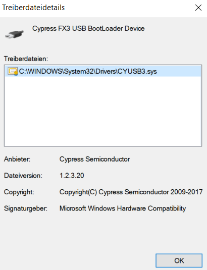

My guess is that it's the wrong driver. Can you Save (Speichern) and upload for me?
Re: Installation of RX888 in SDRC V3 failed
Dear Simon, I attached the details of the Cypress FX3 USB driver. Sorry, it is in German and hard to read. I got it from your page. When I try now to replace it, I get the message that the current driver is the most recent. I could delete it anyway and renew it. Should I try this?
