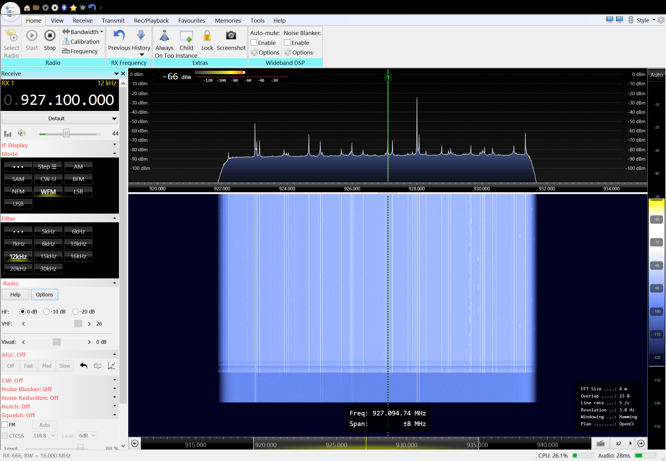

My RX-888 just arrived today. Had to download the drivers (actually the whole SDK, which includes the drivers for several OSs) from the Cypress website, as the Win10 drivers don't work on Win8.1. Similar to David GM8XBZ's experience with his i5, I'm having issues with BW settings over 2 MHz. My system is an i7-4770 with integrated graphics (no CUDA). It still works well up to 4 MHz, though stutters a little, but 8 MHz lags badly & is unusable.

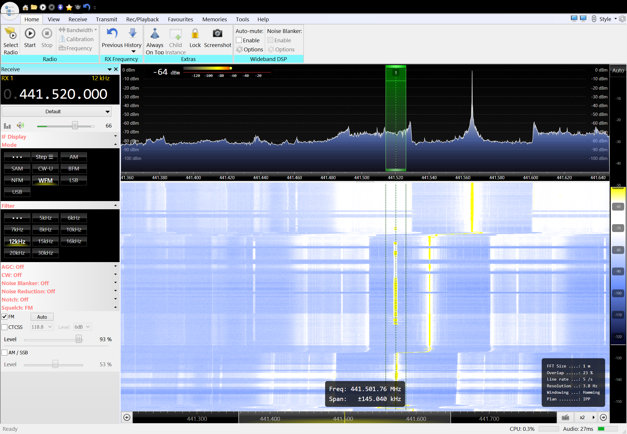

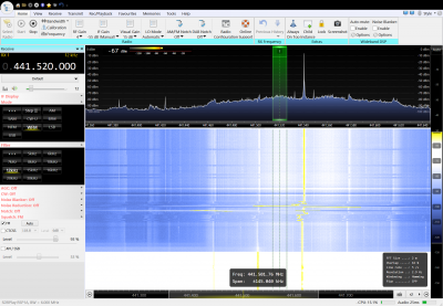

Early indications are that the phase noise @ UHF is excellent. Looking at the output of my HP8640B I saw some strange sidebands starting +/- 30 kHz out from the carrier. Turned out those are intermodulation of the signal coming from fluorescent lights in the shack; if I turn off the lights those sidebands disappear. Impressive!!! Now if only we can get this thing to work @ 8 MHz BW.

BTW I forgot to mention: in the above screencap I posted the RX-888 had an SMA whip attached to it, so coupling to the HP8640B was through the air, not via coax, & of course the CFL lights were nearby.

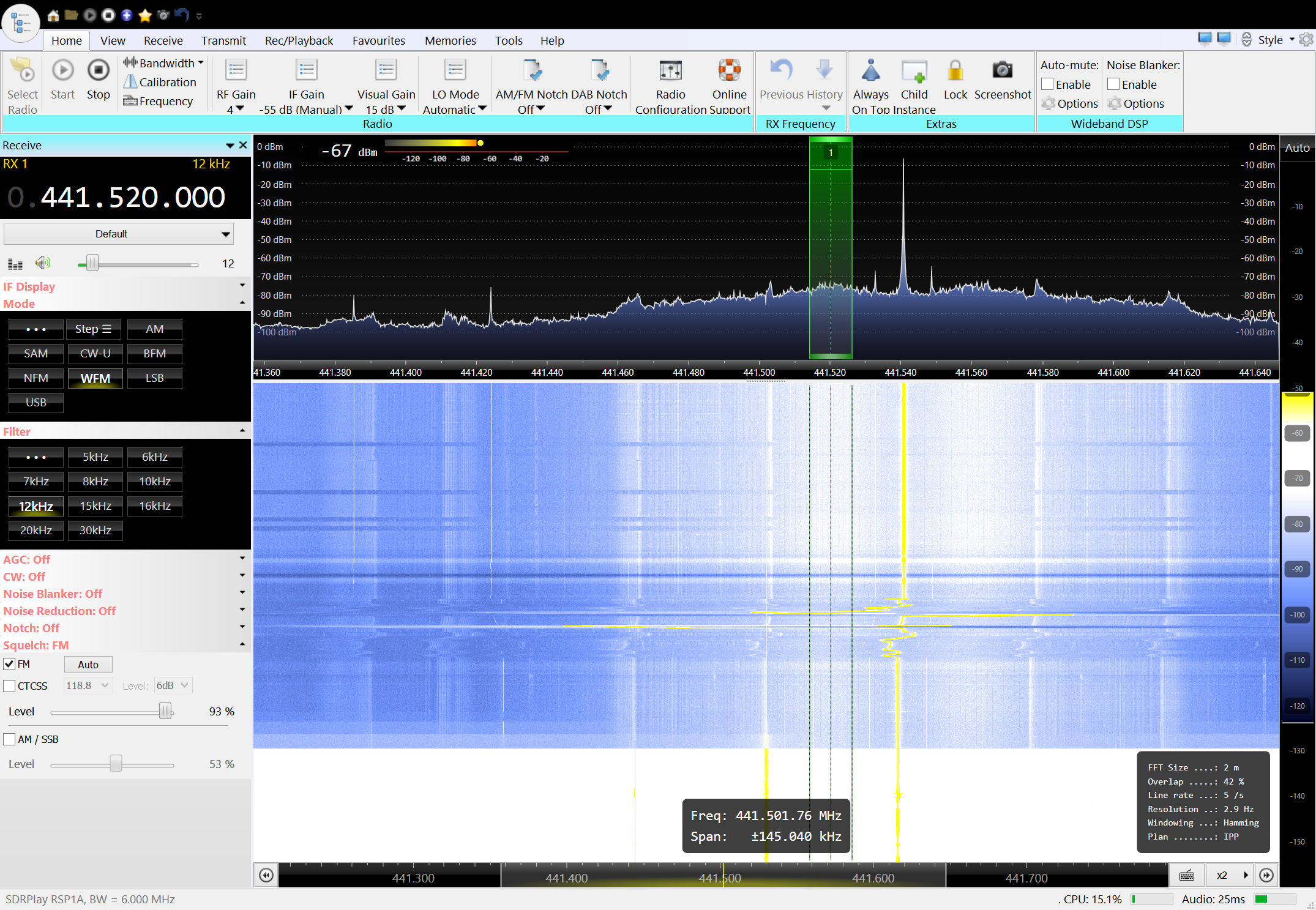

Also BTW here is a screencap of my RSP1a receiving the same signal from my HP8640B. Aside from the tiny bumps @ +/- 40 & 80 kHz from the carrier there is no change when I turn the shack lights off (you can see the small change in the waterfall as I turn the lights off & on just before I took the pic). THIS is just one reason why low phase noise is so important, & why I'm so excited to switch over to the RX-888.
