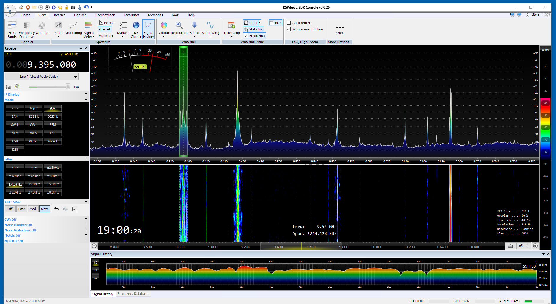

Listening to a spot of music on WRMI 9395. Not sure the CPU can get much lower.
Mike

i get pretty much the same on my build from last week. I've now transferred the OS from a SATA SSD to an M2 and that's made a considerable difference to boot time and everything else.
