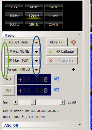

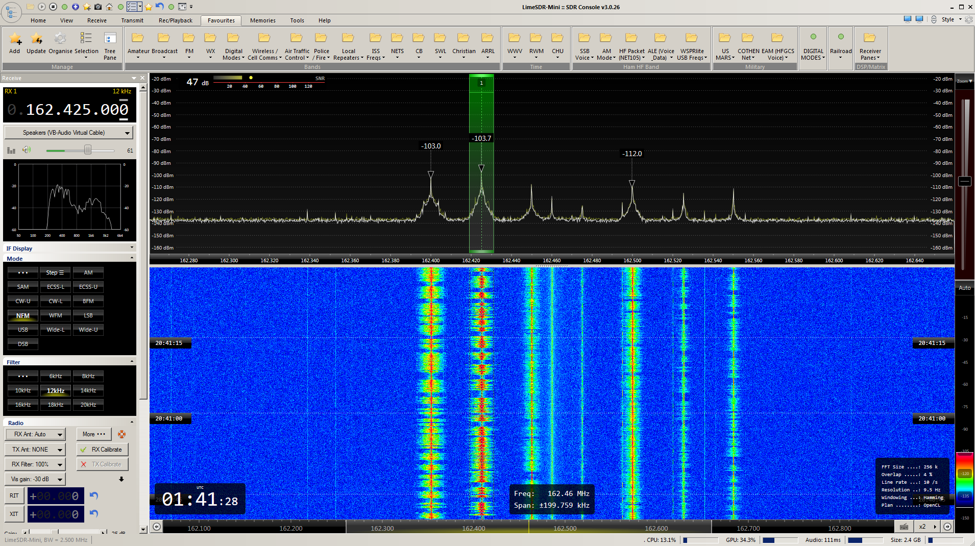

Not sure exactly what issue(s) G4SDG was referring to in the previous message, but I do have one issue to report when using the Lime Mini. The full screenshot from SDRC is attached, but it does not clearly show the issue. So I attached a second smaller screenshot image which better shows the problem.
In the Radio Options on left edge of the SDRC Main window, when you click on any of the drop-down menus (circled in blue) ... all you see displayed is a narrow vertical bar on left where the green circle is shown. The drop-down menu selections seem to be intact on that bar since you can "blindly' select valid entries from the list.

Silly question - What happens if you pull the whole Receive "task bar" wider and then try the drop down?

Widening the Receive window as well as undocking and even fully expanding it still leaves all the buttons and drop-down menus at exactly the same size and position ... i.e. fixed/referenced/registered to the left edge of the Receive window. The only controls that actively and noticeably resize/readjust within the Receive window are the Audio Spectrum graph and IF Display waterfall.

PD3LK, I am not entirely sure which of the two comments/points you focusing on here with the suggestion to use an alternate Identity. So I will address both.
I created a new (additional) Identity and then assigned/defined the Lime Mini as the only radio there to see if that made any difference with the operation of the drop-down menus in the Receive window. The outcome was the same as before regarding these drop-down menus ... there is still just the narrow bar shown at the left edge when each are opened/activated. So no change there.

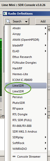

BTW: In the Radio Definitions 'Search' drop-down listing, the 'LimeSDR' reference is showing up twice within the listing. (screenshot attached) I tried each/both and there doesn't seem to be any difference between them. (FYI: I don't know if this listing is picking up any of the SDR devices defined in the Main/Primary Identity (I wouldn't think so). In my Mail Identity the Lime Mini is defined there twice ... once under/as USB3 and once under/as USB2.)
