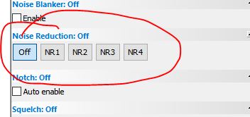

Sounds to me like you might have one of the Noise Reduction settings selected in error in the RX DSP panel. It' a possibility anyway. See attached pic. If any on, try all off.

Max, it appears what I hear is related to the noise reduction settings. If however, I turn all off, it is difficult to suppress the background noise. If I check the noise blanker on, I get no response from that control. Changing sliders has no effect. The NR1 gives the best suppression but I get the result I referenced. Do you have suggestion for best noise reduction settings?

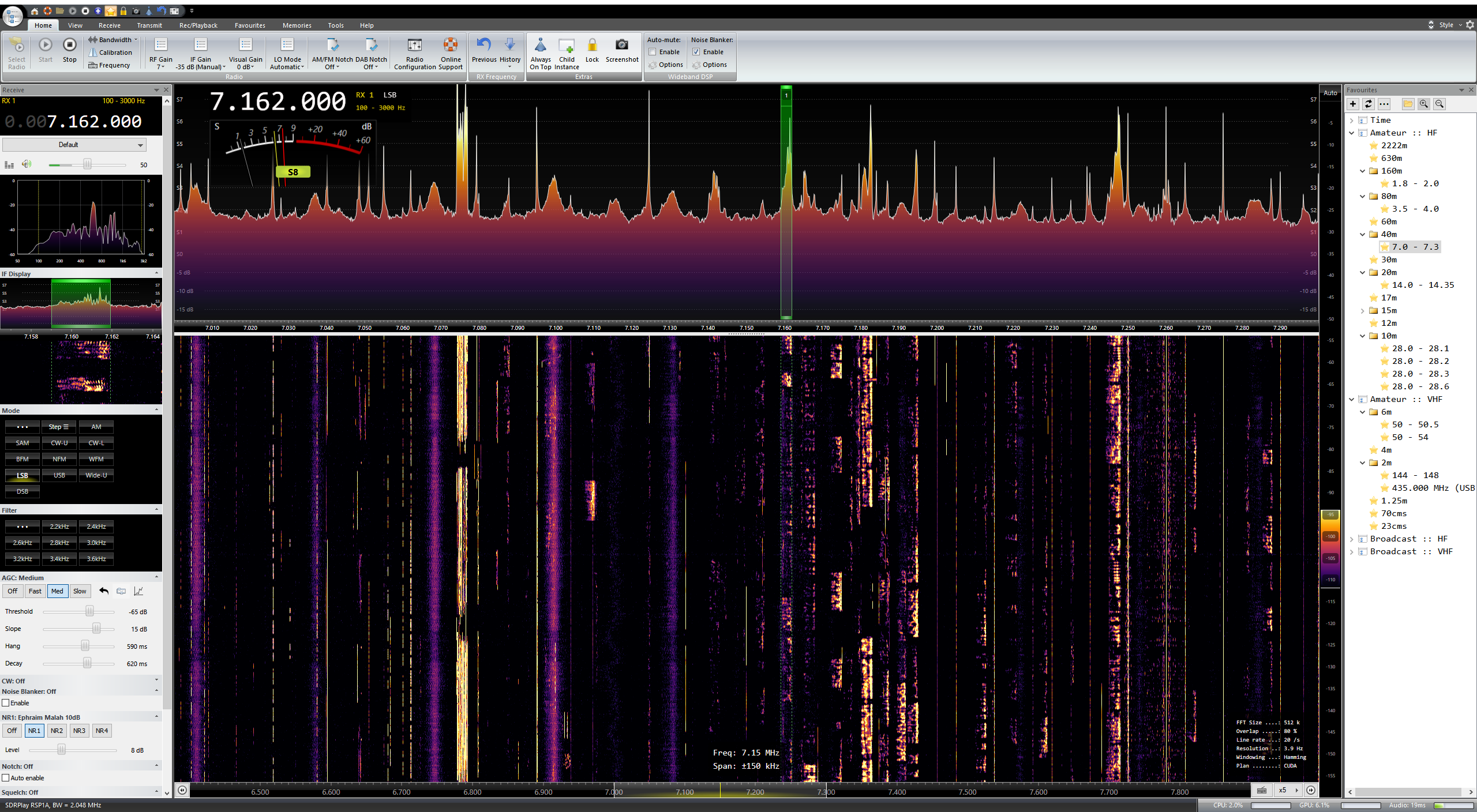

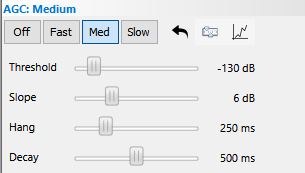

I am listening on an SDRPlay RSP1A. The antenna is a MyAntenna EFHW8010 in inverted V over the tree about 40ft high, fed to the receiver with 12ft of RG8/u. I am in rural Missouri on 8 acres. Nearest neighbor at least 100yds away through the woods. Attached screed shot. Can you shed any light on the AGC hang and decay sliders? How they might effect the signal.
John
John
Re: Trying to suppress this noise...Any ideas?
Actually John your noise situation looks pretty good. You seem to have a basic background noise around S2-S3 (though gain settings and meaningful S point readings can be tricky with SDR Play receivers). But overall it looks good. Here in the UK many people in urban areas complain of S8++ constant noise from every type of annoying source!
Regarding AGC settings, I find the defaults work very well. I don't think I ever changed them much. Hang is the time after signal stops that the decay begins, and decay is the time it takes to decay AGC back to "normal" level of gain (crank the gain back up to "full").
I probably leave mine on MED most of the time. Here are my own settings. They are very "mild". (See attachment).
