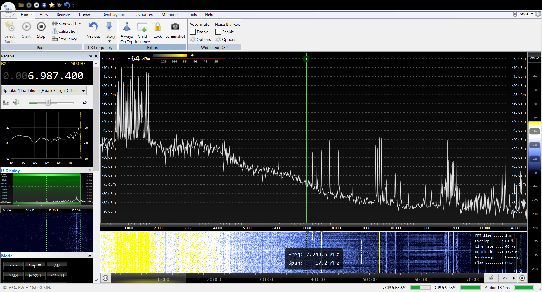

I just received my RX-888. Since I like to listen to the bands by "tuning around" I will enjoy exploring a wide swath of spectrum.
I connected it to my wife's I7 laptop since my I5 has difficulty about 4MHz of bandwidth.

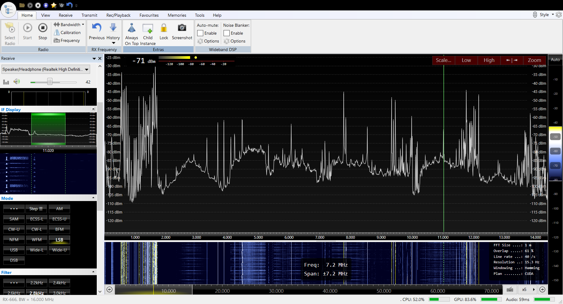

I connected my 160Meter Inverted-L and monitored form the LF band to 20 meters. It is overloading I assume form the AM broadcast band signals. I inserted a AM broadcast band filter and the display is more representative of the actual signals.
Is there a way of internally controlling the gain short of adding and external filter or attenuator?
I have included screenshots without and with the filter.
Mike N2MS

"I connected my 160Meter Inverted-L "
Which may not be the best antenna to cover a wide range.
I think the only way is with a wideband antenna and filters. To use the whole 30MHz a preamp targeted at the higher frequencies may be used as well to even out the response.
Alan

If the ATT has been adjusted to -20db, then there is no way to adjust it down. Only an external attenuator can be added. I have never seen such a strong signal, and I have never encountered such a situation with my 20-meter long wire antenna.

Thanks, I had missed the Radio attenuator options under the Receive Panel.

mstangelo wrote: Fri Oct 23, 2020 7:20 pm Thanks, I had missed the Radio attenuator options under the Receive Panel.
Mike N2MS
In my actual use, -20dB attenuation is enough. Normally there will not be such a strong signal.
