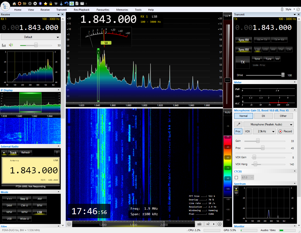

trying to get it to work with sdrc as external radio.
no hope..(except for once yesterday, and i have NO idea how!!)
using serial to usb to pc.pc sees it and says all good..(worked yesterday.)
omnirig set up on same com port (com 4.) as pc sees it.
omnirig and ftdx set at same baud rate. (38400) as is pc.
cat rts on ftdx set on.(tried off .same no go.)
cat select on ftdx set to rs232..(as using serial to usb.)
cat does NOT show up on elad sdr display.(does when working.as in yesterday..)
tried switching on rigs before and after starting sdrc..etc..no effect..
followed sdrc web page to the letter.
all i get is ftdx3000 is not respomding in the external radio window..OR gives me port is busy..screenshot is of not responding..
just to add tried every option in ftdx cat menu..many times..
been at this now for HOURS!!..tried everything my limited knowledge allows.
please anyone HELP!!!...

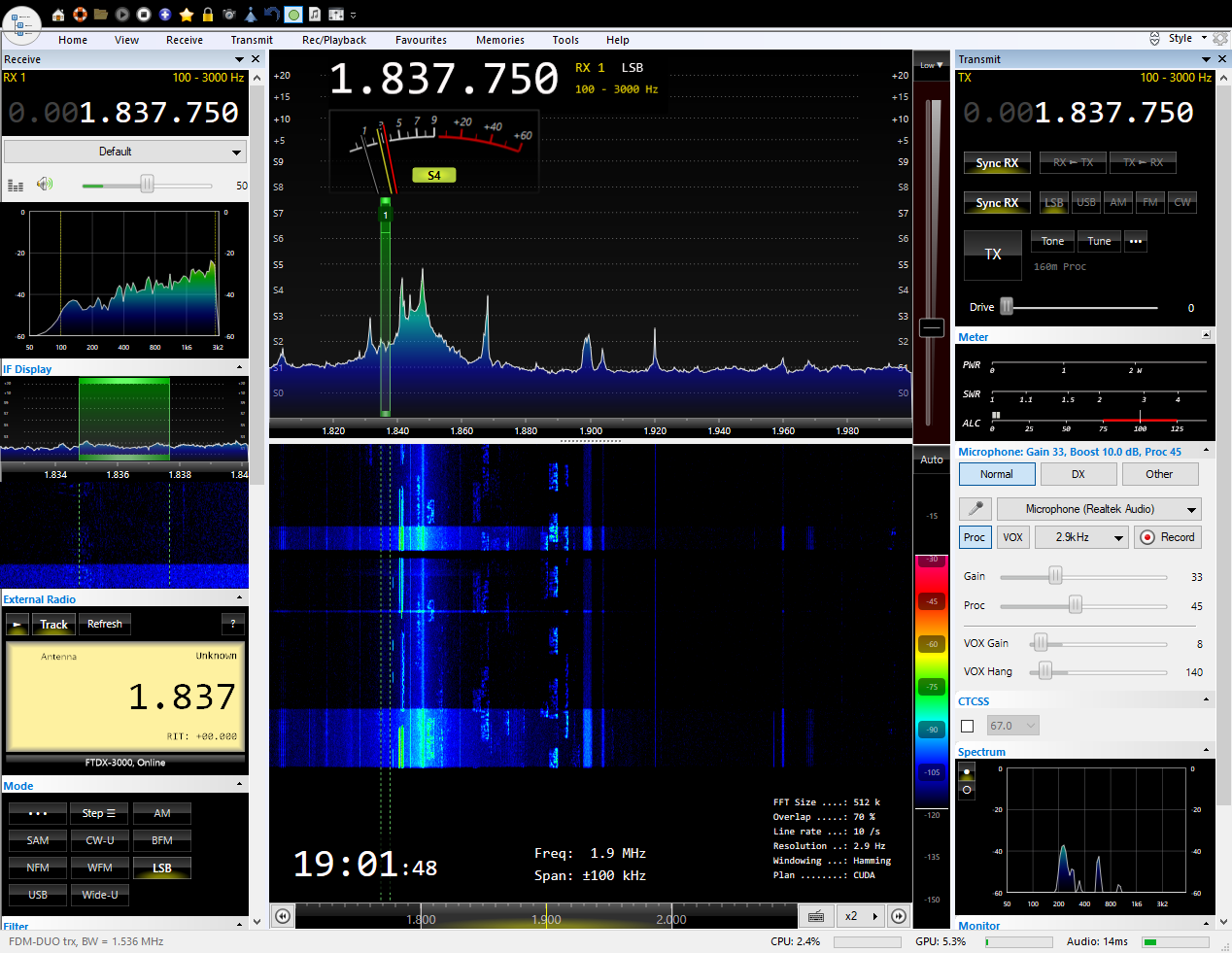

update..
checked on elad duo..baud rate had changed!
put all to 9600..now sdrc says ftdx3000 online..except it is not..no tracking..no antenna selected etc..PLUS it only shows part of fequency..see screenshot..
PLUS elad duo goes into tx and will not switch out of..
really confued now..
