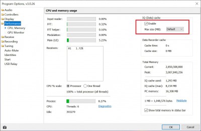

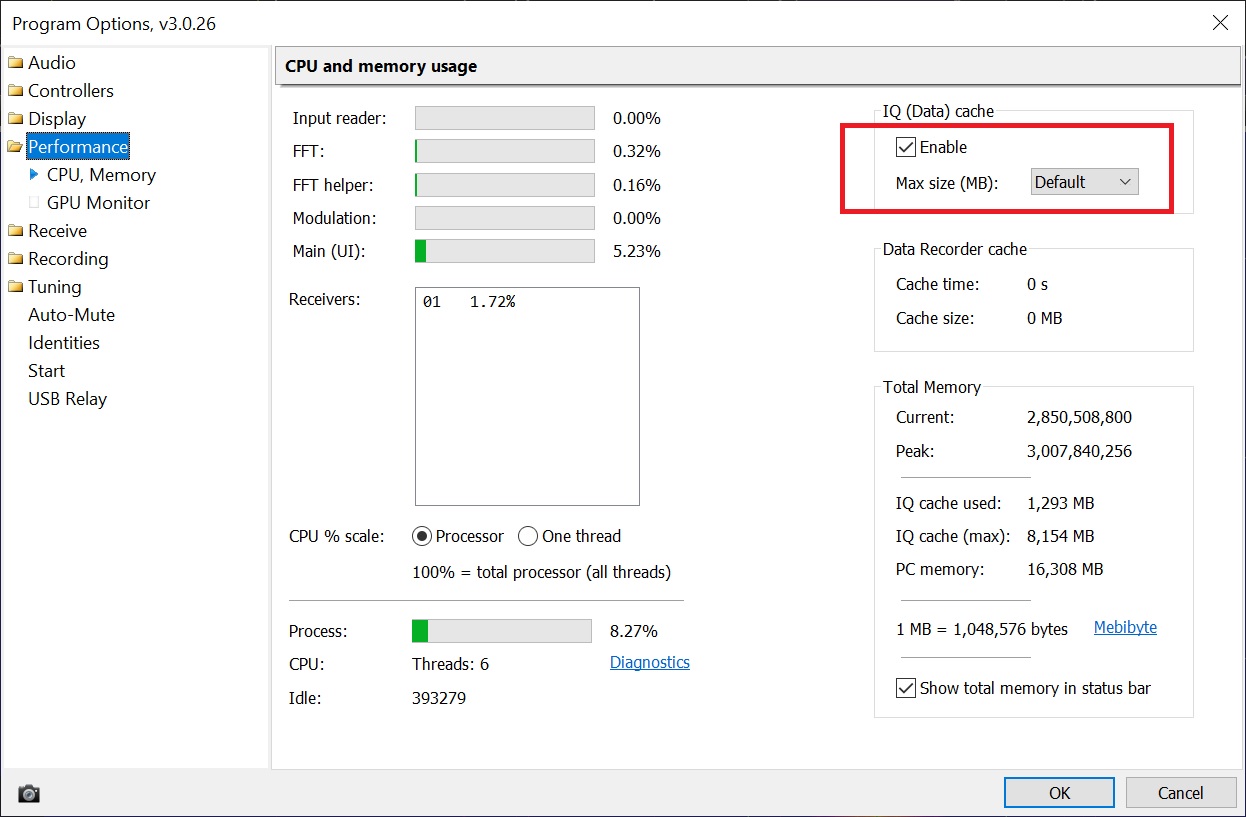

Re: Waterfall disappears on tuning
Have you disabled the cache?
A screenshot of Console running will help a lot.
vk2lx
Posts: 7
Joined: Sat Sep 26, 2020 9:57 am
Unread post by vk2lx »
Thank you Simon
The cache was indeed disabled! I am embarrassed however all is working now
