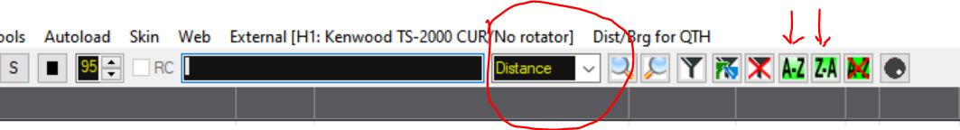

In CSVUB, say I have a list of stations showing, I would have expected to be able to click the column header (in my case I want to sort by distance) and it will then cycle sort ascending/descending or none with each click, but when I click the column header all the entries disappear. What am I doing wrong?

Hi Max,
for sorting..
Select the parameter you want to sort from the drop-down circled.
Change the order with the buttons I've arrowed.

That's great. Many thanks Jim.
