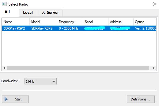

I have an SDRPlay RSP2-Pro which currently works very well with SDR Uno, I've installed SDR Console but when it starts and correctly identifies the RSP I hit Start and app opens but doesn't Start "if that makes sense"
Images attached for clarity.

Try different USB cable and always from a powered hub or direct to PC, so try different USB sockets too.
Many RSP range issues are from insufficient power on USB connection.

Thanks Max,
I already tried that, I have the RSP2 plugged into a USB 3 PCI expansion card on the PC workstation, each USB port supplying 2 amps which is more than enough, RSP2 only draws 0.17 amps (excl Bias T)
But have tried all the other USB ports just in case but same issue, RSP2 works fine on SDR Uno so can't see it being a hardware issue.

Thanks for all the help Guys
I removed the SDRPlay definition and rescanned, all working now
