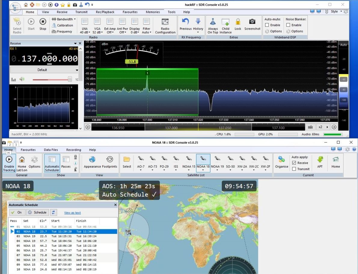

I'll dig into the code, this could be possible. A lot depends on overlapping passes, so a screenshot showing me the pass data would help.

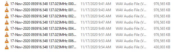

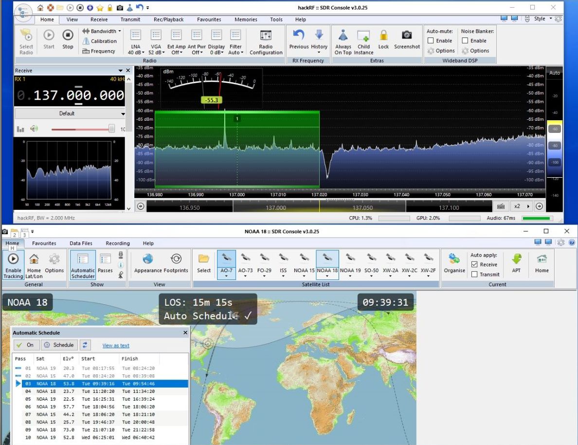

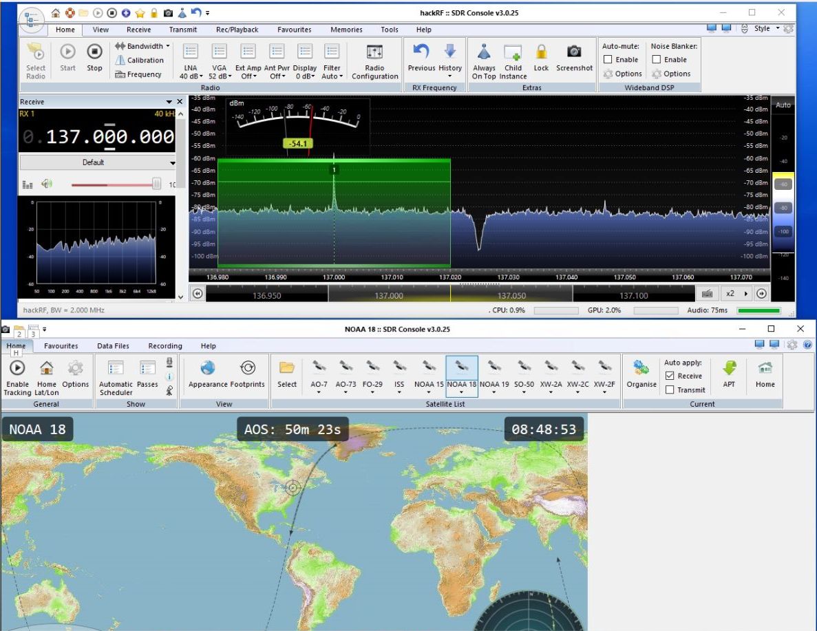

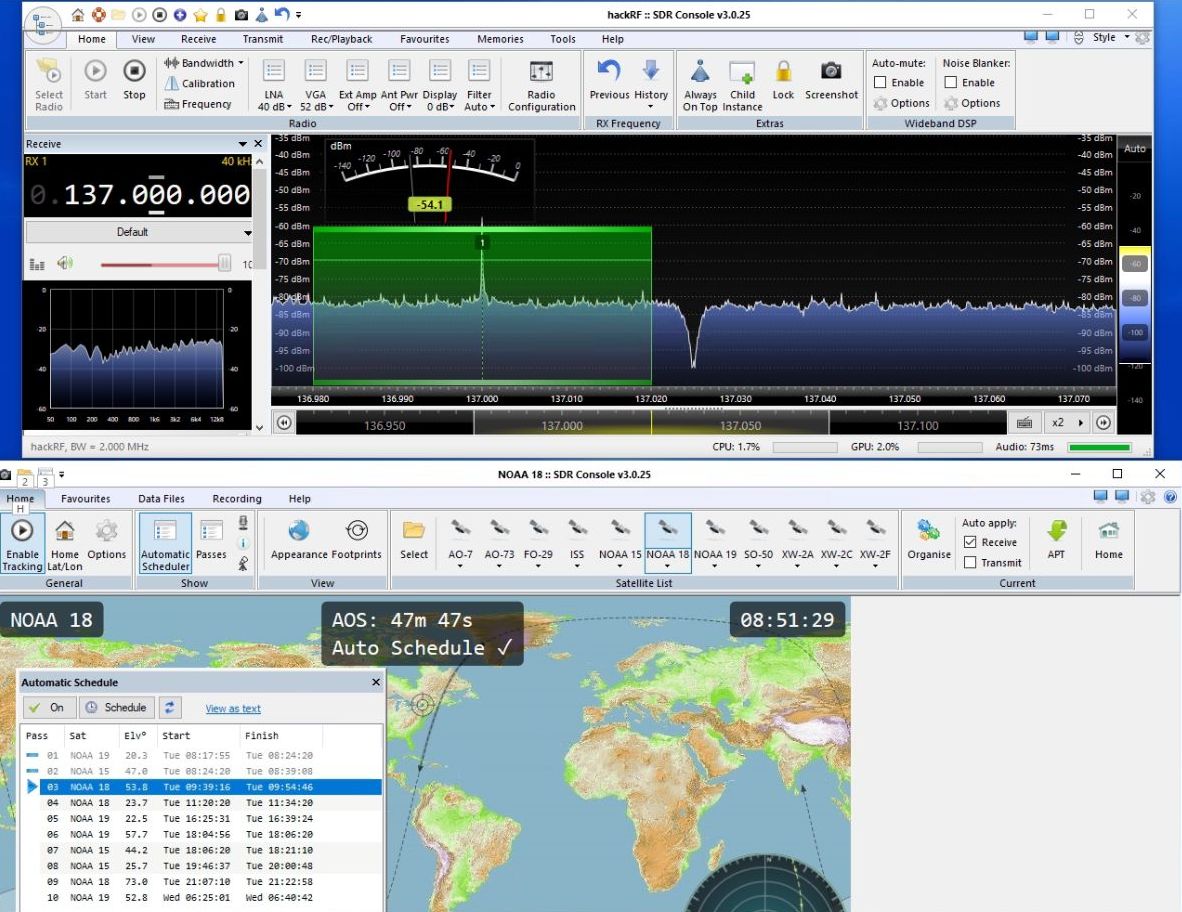

Here is an example from this morning of SDR Console not changing frequencies. I started with Automatic Schedule off and Enable Tracking off. I tuned to 137.025 MHz with the WFM centred on 137.000. Then I turned on the Automatic Scheduler and the Enable Tracking. The frequency did not change even though it showed that NOAA 18 was scheduled. Its frequency is 137.9125 but the frequency and the display remained centred on 137.025. Then when AOS happened, there was still no frequency change. After that pass, the next pass was also NOAA 18. But again, there was no frequency change. And the I/Q data file that was recorded had the name "17-Nov-2020 093916.548 137.025MHz 000.wav" and not NOAA 18's frequency. Here are the 5 screen shots that show that sequence:
