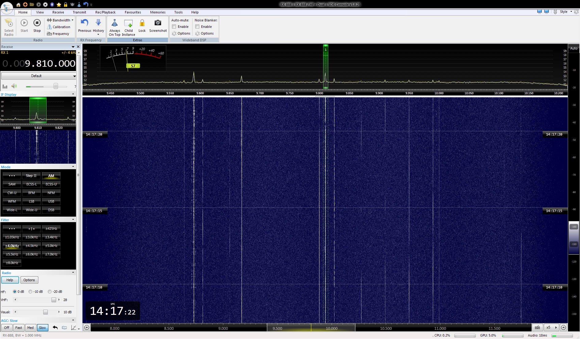

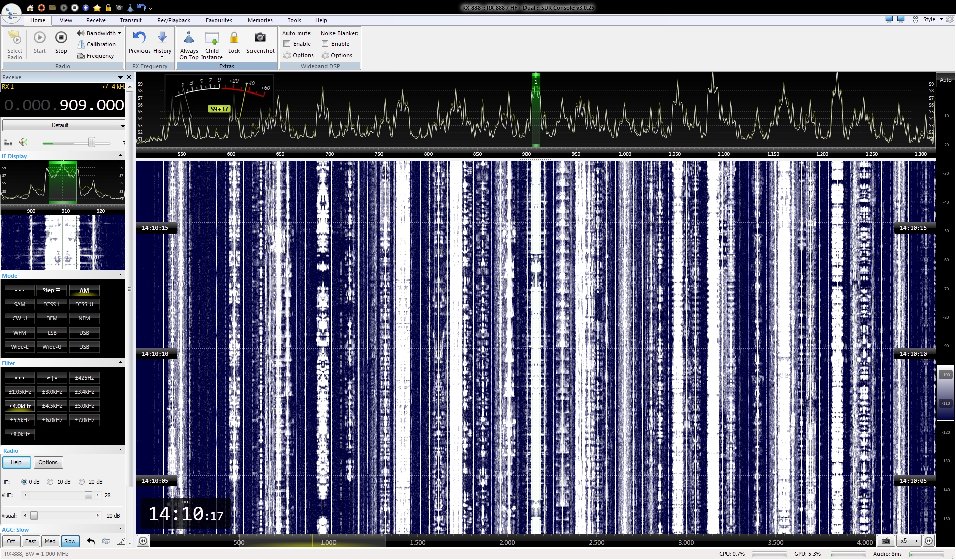

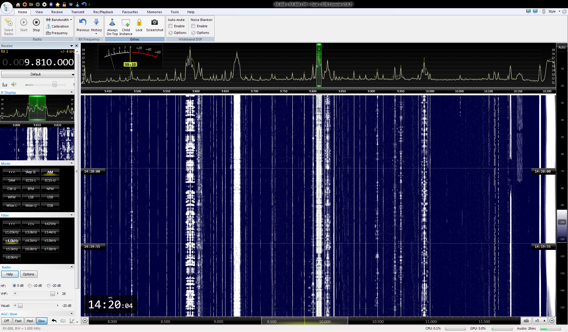

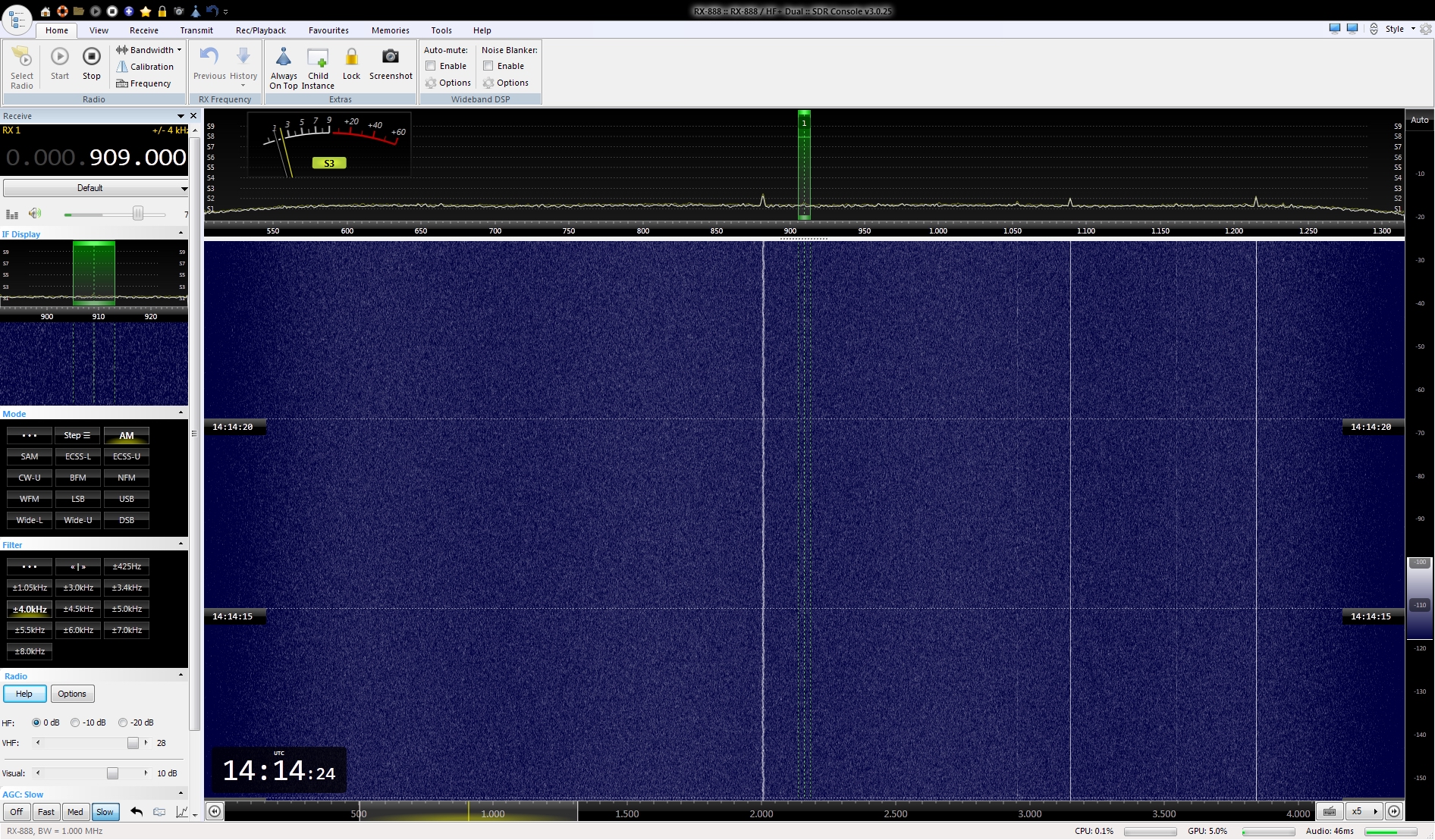

Only the very strongest signals show up in the SW bands, nothing at all in the MW band - see attached.

Posts: 2165
Re: New firmware for RX-888
Ah,
I think I read about a change in this logic. A RX888 is on its way to me, I'll get this sorted out when it arrives, until then we'll have to stay with the original firmware.
