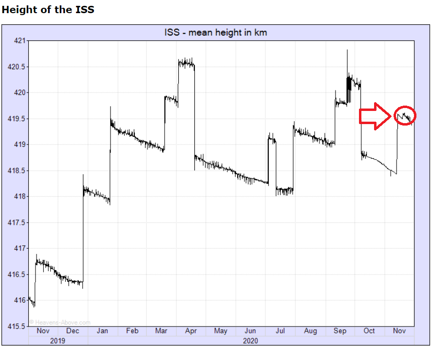

They did get a little boost in their orbital altitude when the Space-X Crew 1 arrived last week. That's all it take to throw off the times a few minutes.
So possibly a change in the Keps?

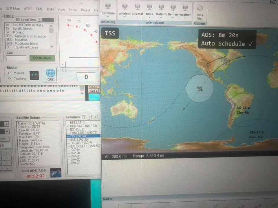

The
attachment shows the PstRotator on the left and SDRC on the right. Note the LOS/AOS time difference.

k3uk wrote: Sun Nov 29, 2020 11:18 am The passpicture.jpg attachment shows the PstRotator on the left and SDRC on the right. Note the LOS/AOS time difference.
I'll check the source for the keps.
Andy
No No No!
For goodness' sake take a proper screenshot and look at the data. A pic with a GSM is a total waste of time.

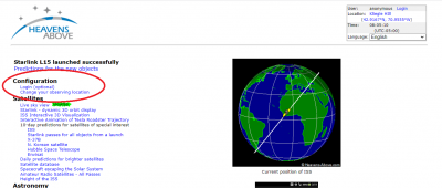

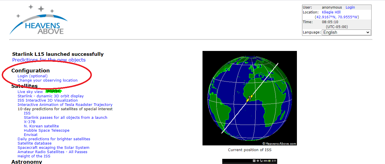

Andy, go to the home page of Heavens-Above, and check out Configuration.
You can directly enter coordinates or us the map and click on your location (be sure to zoom in once in the general area).
Also make sure the proper time zone and offset are good.
You don't have to be a member, i.e. sign up. It will remember your location until changed.
