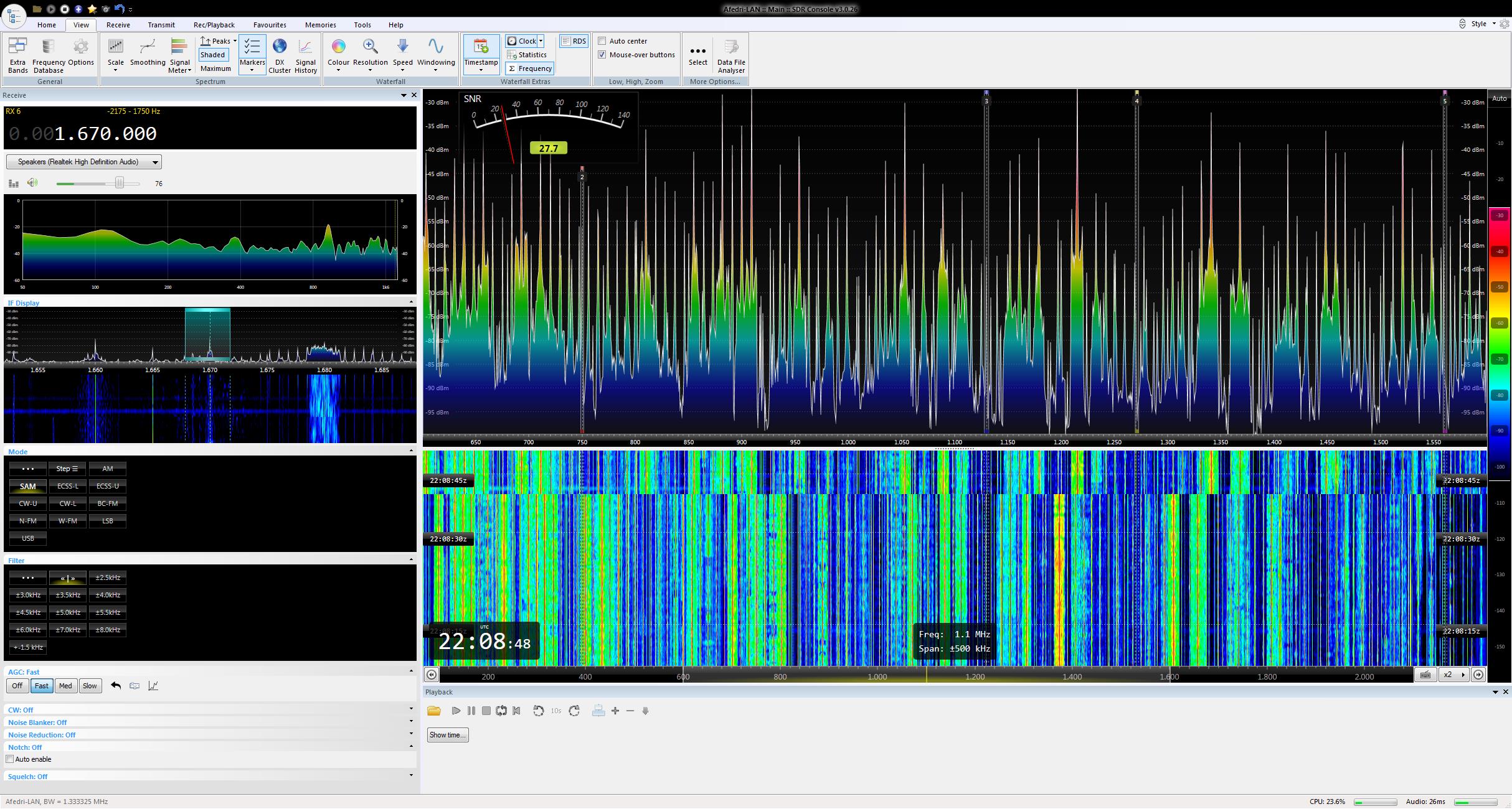

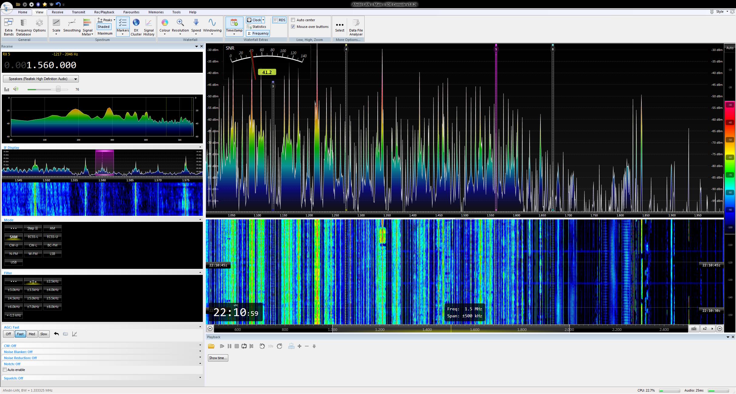

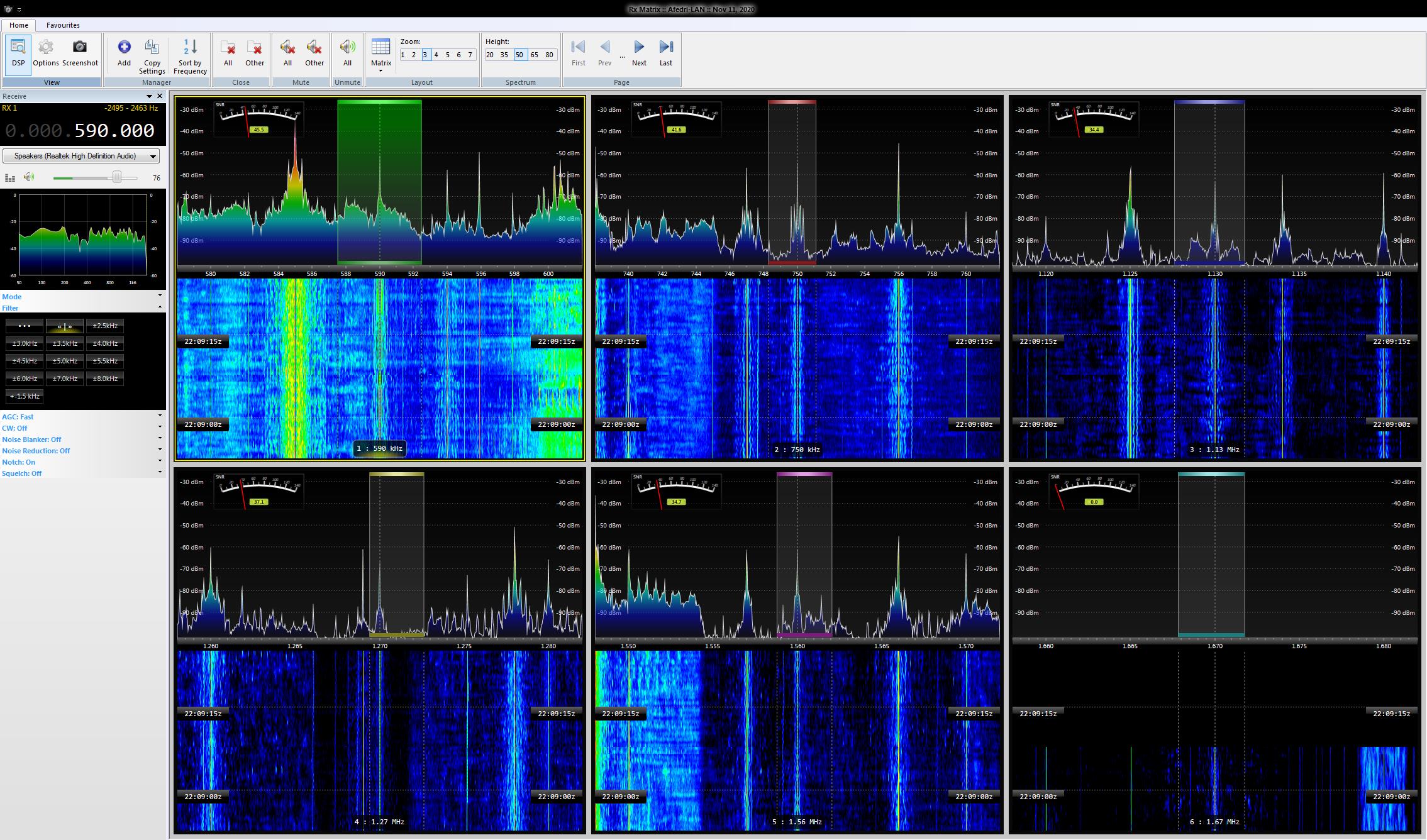

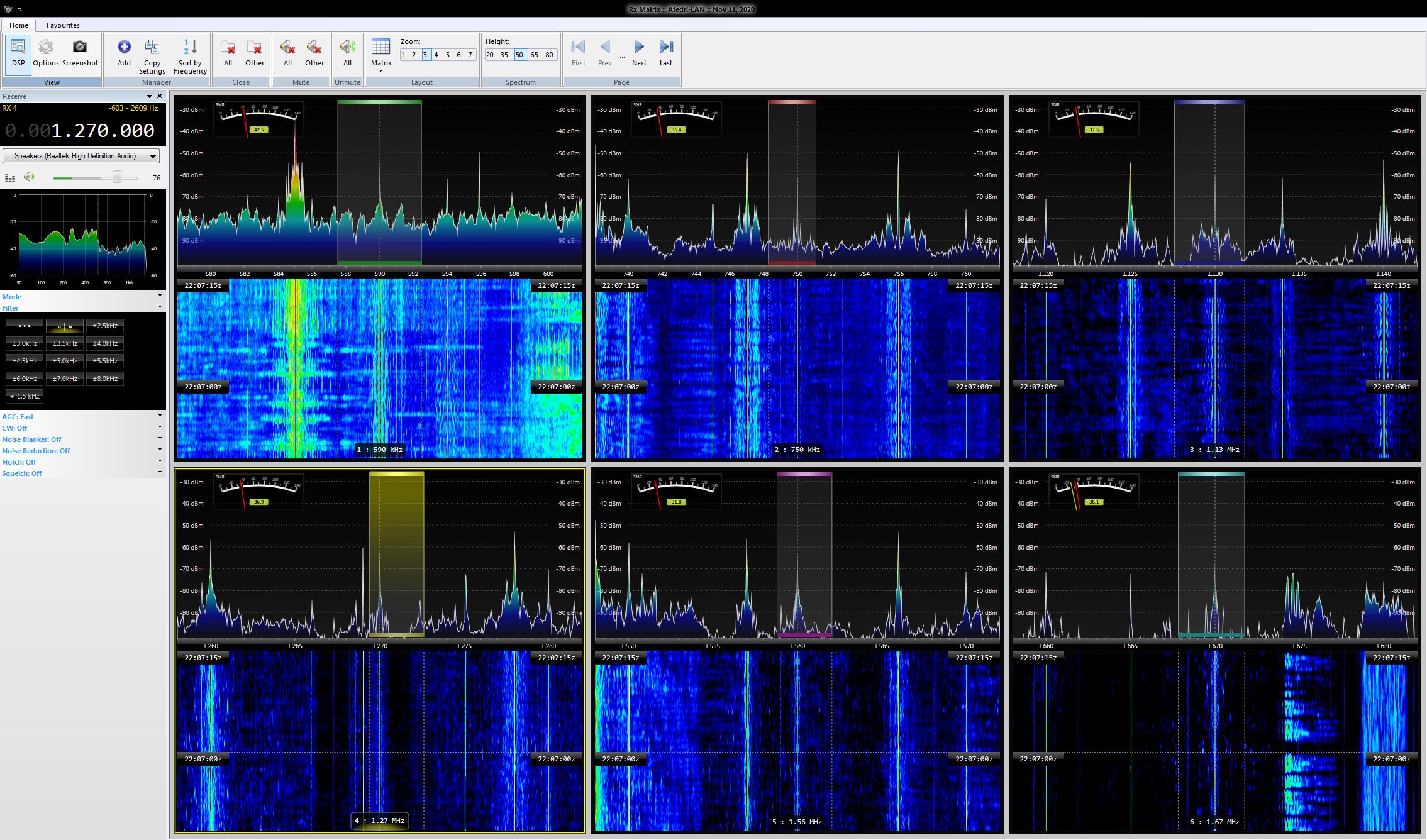

Hi.
Is there a way to lock the center frequency of a desired span from moving when changing receiver (receivers spread across the full band) from one at one end of the span to one at the other end of the span?
As illustrated in the attached screenshots the wanted center frequency of 1100 kHz to another frequency when choosing a receiver at the far end of the desired span.
This results in one or more receivers fall outside the span and the spectrum and waterfall gets black.
I would like to be able to keep the same center frequency and span even when jumping between different receivers.
The span also changes from the wide setting (first screenshot) to a more narrow setting when stopping and starting the radio again.
73 / Ingolf, SM6FHZ

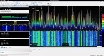

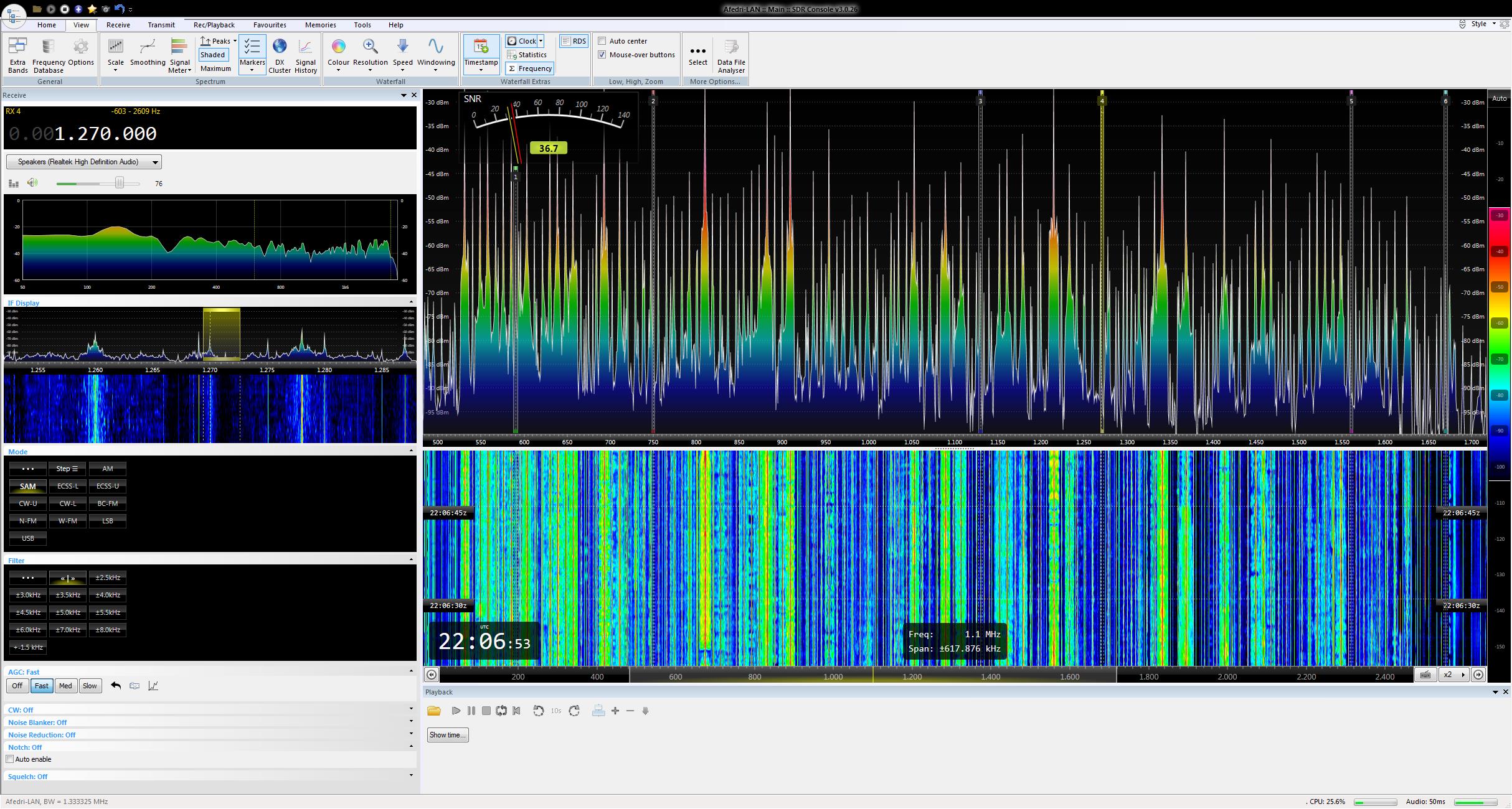

One more screenshot to be added / Ingolf

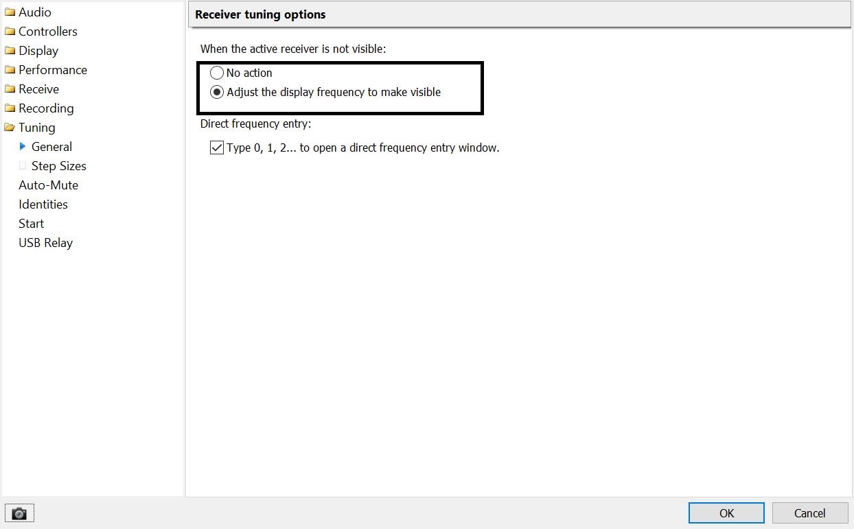

Posts: 2174
Re: Span and center frequency jumping
This is the reason - see attachment.

Unread post by sm6fhz »
Thanks Simon.
Seems like it cured the blank extreme receivers :-) Easy when you know how to.
However, the more narrow span shown when stopping and starting the receiver still is in effect. But, that is not important at all. Would be interesting to know why it does like that, if there is a reason for it.
73 / Ingolf, SM6FHZ
