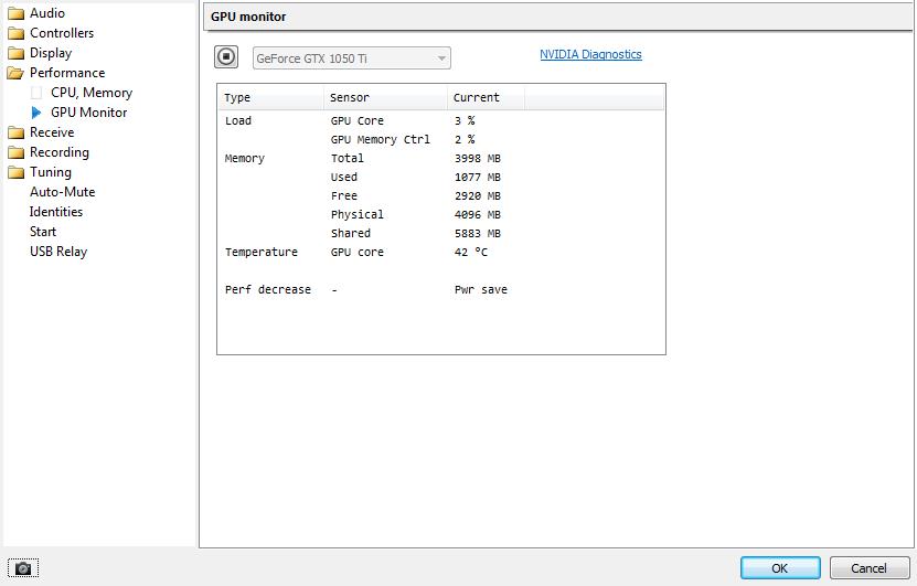

The GPU Diagnostics says "Pwr. save". Can I change such a setting somewhere? I have not yet found a control device for the new video card (<24 h old in the PC).

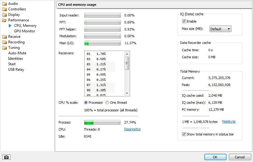

I attach some hopefully relevant and useful screenshots.

I have tried to configure the MSI Gforce GTX 1050Ti card for maximum performance but SDRC still says "Pwr save" mode in the GPU monitor window.
Any idea on how to exit Pwr save mode and activate Maximum Performance mode?

1) Please show me the Pwr save message.
2) You are really at the maximum I am afraid, the main thread of SRC Console is overloaded, that's why you're waiting so long to see changes on the main waterfall.

The Pwr save message is in the screenshots (the lower one, "GPU monitor") in the start posting in this thread.
I can not find any more knobs to turn nor any more switches to flip in the Nvidia Control Panel in order to get the system understand that the Pwr save mode is no no. I have searched the Internet for advice and checked the ones I found.

GPU-Z is good for monitoring the PC, as I said running 20 RX is quite amazing but unless I do some 'adventurous' programming you'll have to live with what you have. 20 RX is amazing for this system.

I got the GPU-Z and installed. All looks OK and no signs that the Geforce GTX 1050Ti would not work as expected. Nice piece of S/W. Still the SDRC GPU Monitor window says "Pwr save" :?: Screenshot attached.
Let me know if / when you have an update and I will try it out. Would "Multi threading" use the number of GPU CUDA cores in an more efficient way or is it for the CPU cores?

Again - you are really at the very maximum performance for your computer. If I get Direct2D multithreading working it will reduce the load on the main thread.
Long term you may have to consider a new computer.
