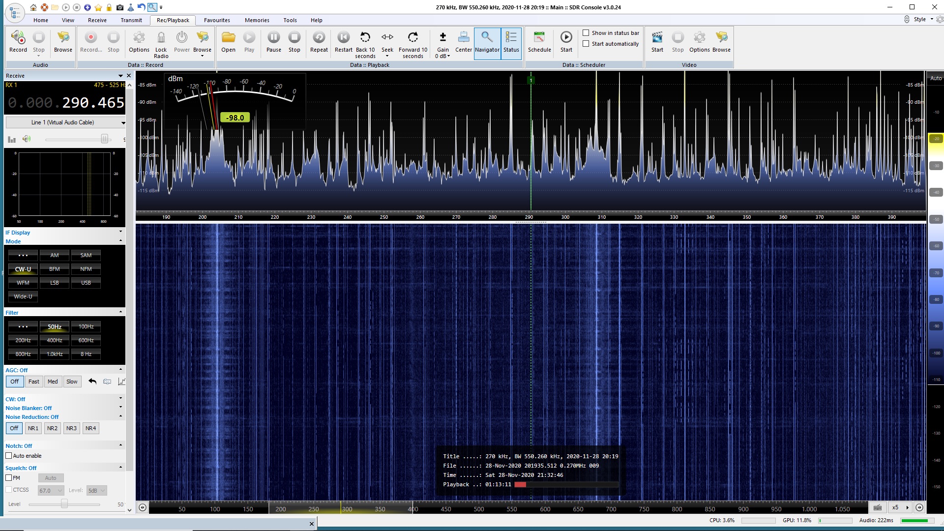

On the third night, the only configuration change is that I changed the radio bandwidth to 768 kHz and modified the recording bandwidth. I intended for this to be 540 kHz wide centered at 270 kHz (so as to capture 0 to 540 kHz), but I see in the recording data that it was centered at 270 kHz with a bandwidth of 550.260 kHz.
When I play back the recording in SDR Console, all signals are about 5.127 kHz below their published frequencies. As a result, NDB and DGPS decoders are not recognizing signals.
The first obvious thing that occurs to me is that the low end of the recording bandwidth overshot the 0 kHz mark by 5.130 kHz -- within 2 to 3 Hz of the frequency error that I'm seeing across the recording.

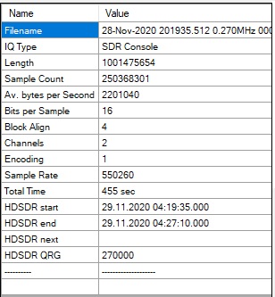

I see that when I open one of the .wav files in PskovNDB (NDB decoder software), it displays a file header which shows a center frequency of 270000 Hz and a sample rate of 550260 -- the latter being the same as what SDR Console identifies as the recording bandwidth. Not clear to me that playing with either or both of those values would fix anything.

The problem is the bandwidth - it's wrong. Any chance you could upload the first file to the cloud for me?

Actually I have a fix, thanks to great help from DR53.
On his suggestion, I downloaded the binary editor HxD and used it to locate the string "R.a.d.i.o.C.e.n.t.e.r.F.r.e.q.=.2.7.0.0.0." in one .wav file, then changed the value to "2.7.5.1.3.0.". The file now shows correct frequencies when replayed in SDR Console v3.0.24, and PskovNDB and Amalgamated DGPS are identifying signals correctly.
