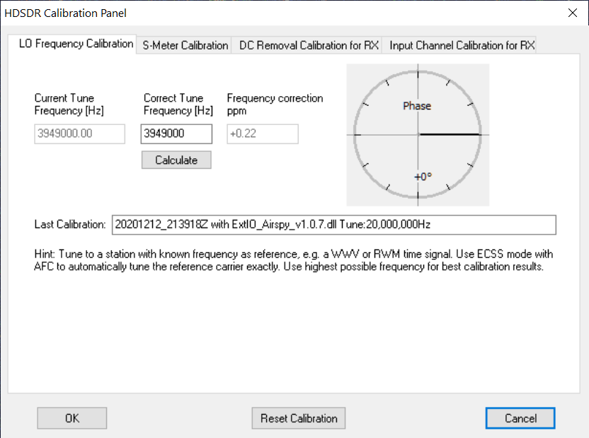

Wondering how difficult it would be to incorporate something similar to how HDSDR does it:

Simon,
Yes, of course, the VFO must be locked to a reference signal. That screenshot was intended to capture the implementation of the feature, and I had inadvertently already tuned away from the reference frequency when the screenshot was taken. However, the pic does show the date, time and frequency when the last calibration was done.

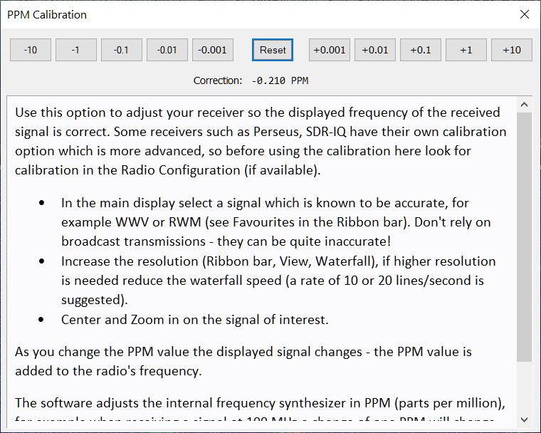

What I'm referring to is basically the ability to automatically adjust for any PPM error in the radio's displayed frequency, which currently must be done manually in your PPM Calibration window:
Mark
