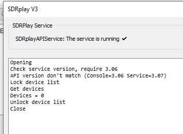

Does anyone know what the attached message is telling me?

I suspect you recently installed the SDRplay API v3.07
Delete the RSP1A Radio Selection and make it again.

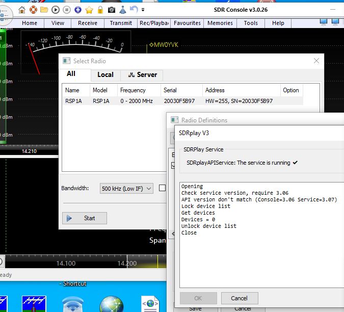

PD3LK wrote: Tue Jan 05, 2021 6:30 pm are you trying to open your own RSP1A via the Server or direct?
Sorry, I don't understand the question.
If everything is working correctly, when SDRC starts, the RSP1A window opens automatically and the output of the RSP1A is displayed graphically, with cluster spots overlaid.
When it does not work correctly, the window opens, but the RSP1A output is not displayed. The cluster spots are displayed. If I click the small 'Play' arrow icon, nothing happens. If I go to the 'Select Radio' dialogue, I see the error message I referred to earlier.
I don't use the audio output of SDRC at all.
