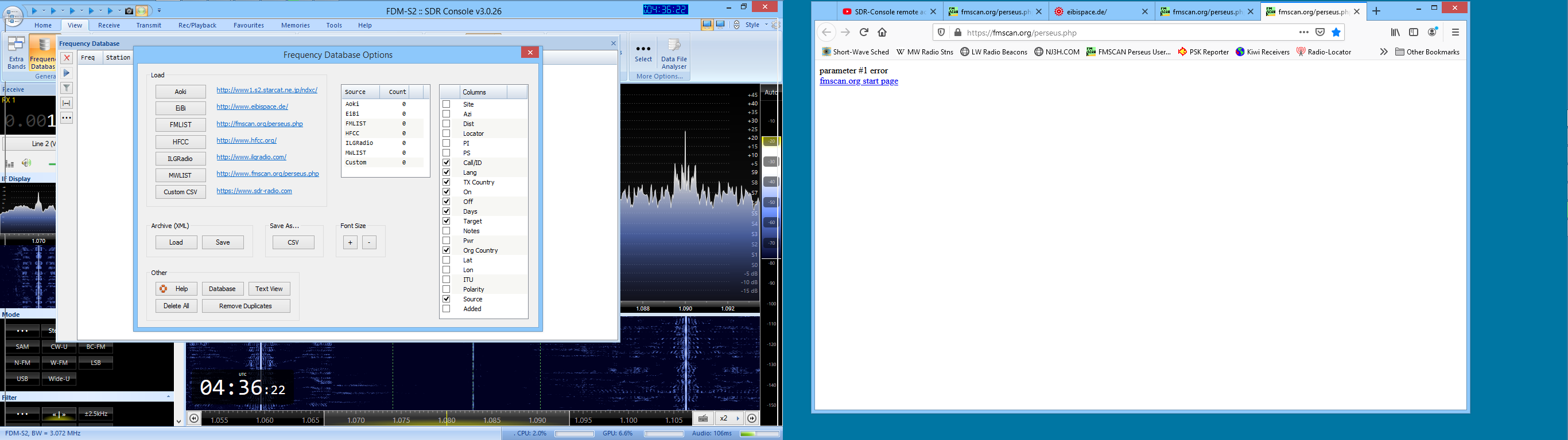

Trying to set up frequency databases for use with SDR Console 3.0.26 on my Windows 8.1 computer.
When I selected either the AM or FM user list, I receiver the error shown on the right hand side of the attachment.
Sorry for using screen capture, but I wanted to get both screens in one picture.

@Simon, the links to FMLIST and AMLIST are both changed to https://fmscan.org/index.php

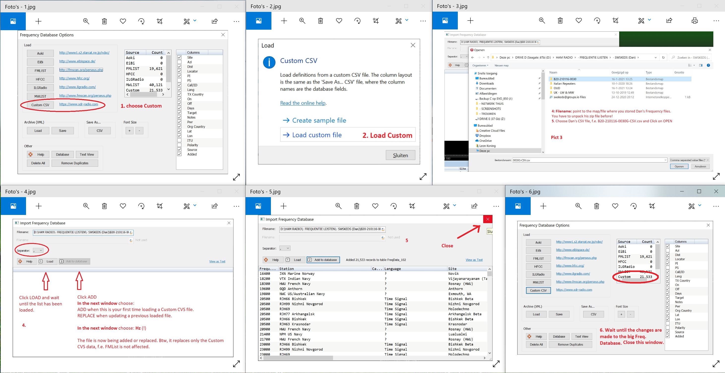

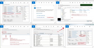

Hi NJ3H, to add Dan's CSV list please follow these steps in attached pictures from 1 to 6.
Regards, Leon
Regards, Leon

Done, thanksPD3LK wrote: Wed Jan 20, 2021 5:17 am @Simon, the links to FMLIST and AMLIST are both changed to https://fmscan.org/index.php
