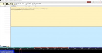

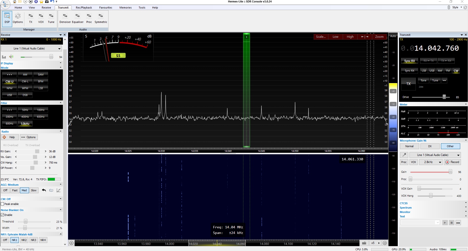

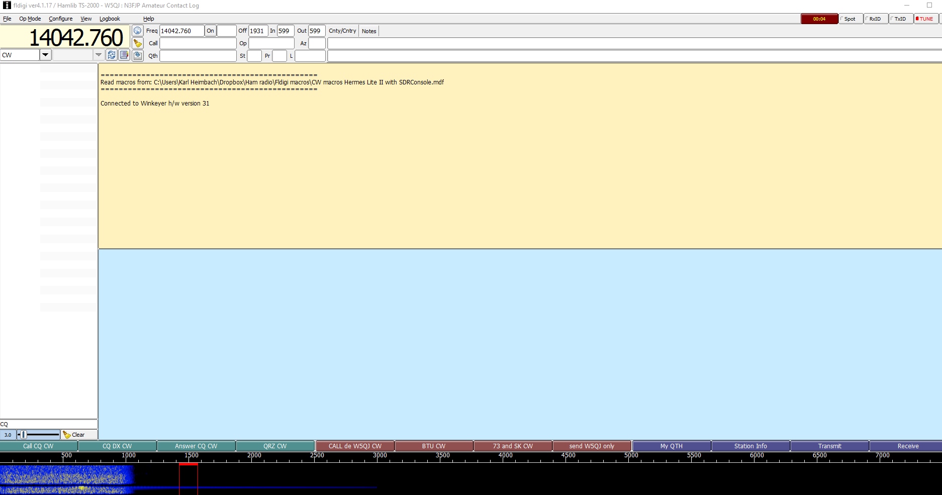

I've attached screen shots of the SDR Console display and one from fldigi with "Tune" actuated.
I have microphone configured as Line 1 (Virtual Audio Cable). If I configure microphone as Microphone (USB device), the PTT also actuates when pressing TX or Tune, but no RF from the Hermes.
Karl - W5QJ
Karl - W5QJ

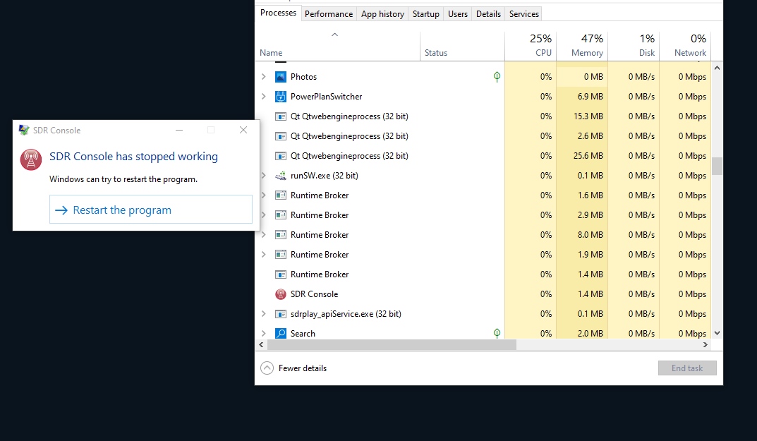

I've also noticed that sometimes SDR Console may not actually close. When I turn off the Hermes via the SDR Console diallog, and then go the top button above the menu bar, and then select Exit, I sometimes get a Windows message asking if I would like to restart SDR Console. I just close that dialog box out and haven't looked in task manager to see if SDR Console is actually still running.

Apologies, I must have posted last night without refreshing browser and had not seen you did post screenshot. One thing I notice straight away is that you have mode in "split" style, so the TX is in CW mode and initially I thought this might be something to do with it, but I have replicated control positions in my SDRC and HL2 and it all works NP even with tones. Had assumed that CW TX mode would allow key only input, but seems not, so that does not seem to be the issue. I still have some suspicion about whether the FTDI interface into the PTT jack may be doing something odd but no idea what.
What I would like to see is a screenshot of SDRC in manual TX mode (in the fault condition of course) using "Tones", and expand out the "Spectrum" window in the TX DSP panel so that the tones are shown. Also with all drives turned full up (Drive in the TX DSP panel, and OP Power in the "Radio" panel). Ideally also a second picture in TX "Tune" mode, again with both TX drives (Drive and OP Power) fully turned up, but in the fault condition of course.

On problem with OpenHPSDR or SparkSDR being opened after SDR Console, looks like SDR Console is not closing on my PC. If I go in and kill SDR Console from task manager, the other programs start up fine.
I've verified this morning.
