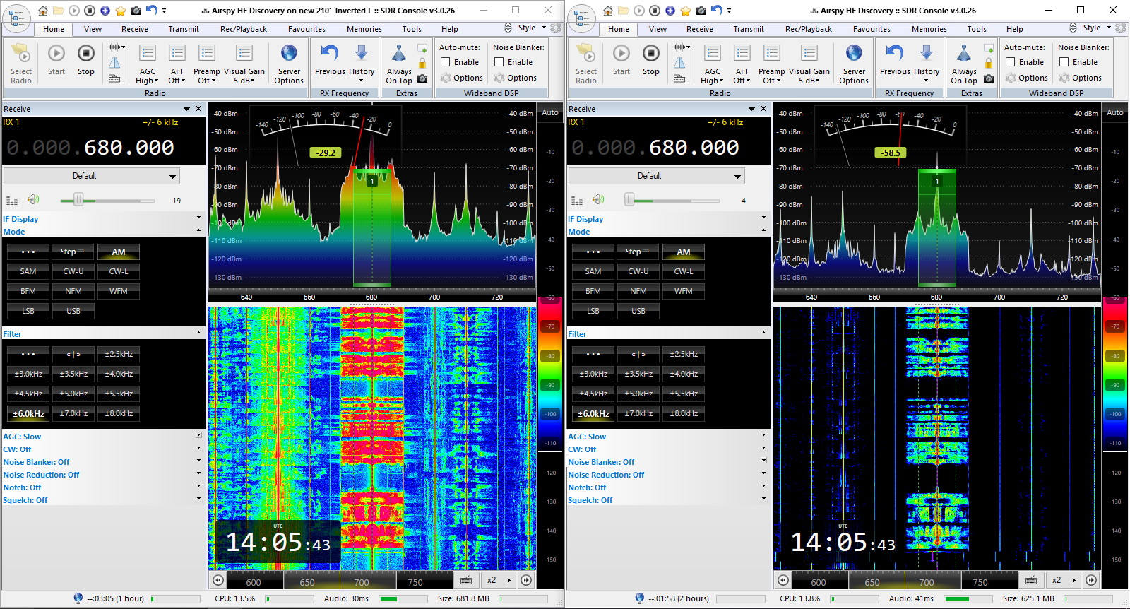

Set the visible bandwidth up so you can see the strong stations, but also see some dead space between. Then sit back from screen and see which strong signal is pulsing the noise floor in sync. Rather easy to do when the offending station is talk radio, due to the voice peaks. You might be able to find the offender by tuning 2X or 3X the AM band. My guess would be WRKO on AM 680. So 2X that would be 1360 kHz (Still inside the AM BC band), but 3X would be 2040 kHz (just above the 160M band of 1800-2000kHz). As I recall from previous emails, you are running an SDR Play of some version. With good antennas, they are easily overloaded with nearby AM BC signals. I only have one in my fleet of SDR's (thanks to a lightning hit!), but I HAVE to have an AM BC filter in front of it. The built in AM BC filter, selectable by SDRC, works somewhat. I built the W1VLF filter and it's on that server, Super Station #2, as noted in the Server notes. So AM DX'ing is really not recommended on that server since the filter knocks down the AM Band by about 30dBm.
OK, here's a test with two instances of SDRC running. Both are AirSpy units, with the exact same gain settings. The left-hand image has no AM BC filter, the right has the W1VLF home brew filter. Note the yellow box under the S-Meter, one is at -29.2 and the other at -50.5. Using 'new math' aka 'public math', that's a 29.3dBm difference! Somewhere, I have before and after images of the SDRPlay that is using the AM BC filter. It too was just dramatic as the image below.
AM BC filters are available off the shelf, or you can build your own with a handful of parts. I have enough to build a few more somewhere in my shop... I think. :o
